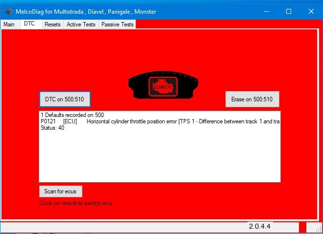

This afternoon i saw with Melcodiag, the error below:
Errore Melcodiag.jpg (55.05 KiB) Viewed 5532 times

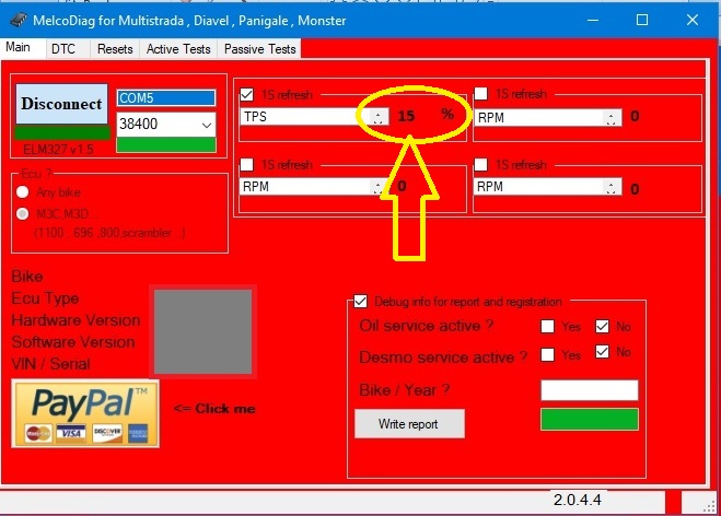

When i whatched it, I whatched the value and it is 15%(please see the yellow row):
Valore del TPS.jpg (94.34 KiB) Viewed 5532 times
well, i went with the reset TPS but, after i touched the relative button, i didn't see nothing. The TPS remain 15% and i still have the same error.

none of the tps fields are working in relation of your throttle position ?
you shall click on the field after scrolling it , to make it blue to be taked into account too

When i selected the field TPS (please see the last image) i read 15% when the throttle are in minimum position. If i remain in this field and i rotate the throttle i see an increase of value. i arrived around 117% (It was the end of throttle rotation)..
After this description I hope to describe that your program work well but the TPS remain at the 15% at minimum position forever also after make the TPS reset with your button in Melcodiag..

just to confirm i'd click into the TPS field to make it blue
Anyway the process looks ok , it would be good to see the angle value , it shall be arround 85% with full throttle

Ok, in the next week I will make your test and i Will be come Blue the field of TPS in your program.
I Will male the test of % in full throttle because i didn't see 85% but much more value (of i Remember well around 117%).

sorry i mean 85° as angle value for full trottle

I control the % in the full throttle position. I saw the value 100% (when i arrived in this position i saw that i had another small part of gas wire but the throttle doesn't misure this extra lenght).
After i tested the reset TPS, higlighted in blues the field TPS. I touched the button "Reset TPS" and after i controlled in the correct field but it remain at the value 15%.
I disconnect and reconnect but the value didn't change.
Another test i tried to press the other two buttons. In sequence "SELF ADAPTIVE A/F" and after "TPS Reset Closed" (in the mean time i saw an OK over green square in the right angle below the window of program). immediatly i controlled in the main menù the TPS and i saw the 15% of value (it remain the same).
I did some mistake? what's the problem that i don't correct the value?
