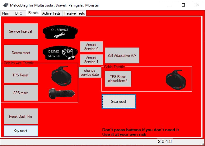

I have just tried the latest Melcodiag from the DOWNLOAD (v 2.0.4.8)
- It starts up OK now - there is no longer the error "conversion from string to type integer not valid".
- I am unable to confirm whether resets work (as I already did my annual earlier with the previous version); note however, I was unable to activate any "button" on the DTC tab (e.g. Scan for ECUs), and on the Resets tab the only buttons that seem to be active are "Key reset" and "Gear reset" : not grayed like the other ones, and turn brighter when the cursor is over them.

thanks for the feedback
it looks like the cle.lic is not valid or locked .
this can be checked in the debug report file
cds31
Joined: Sat Aug 02, 2025 9:41 am
Re: Integer is not valid
Post by cds31 »
at the end of the debug report :
000357929hard :QD0J3010
scrambler detected
soft :1QABAAD1
(I have the whole report if needed);
What do I need to do to unlock the cle.lic ? if that is the cause
try to register again , maybe the cle.lic is not correct
