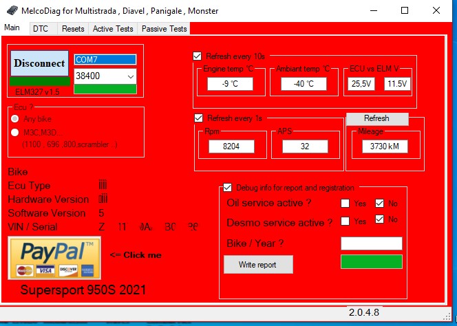

Re: Partial data read - only VIN
a screenshot of the read annual would be usefull to check if the data are well readen
striz
Joined: Tue Dec 30, 2025 3:49 pm
Post by striz »
This?
in reset tab you have a button read annual , i see you pressed it;
i would like to see what it is displayed
