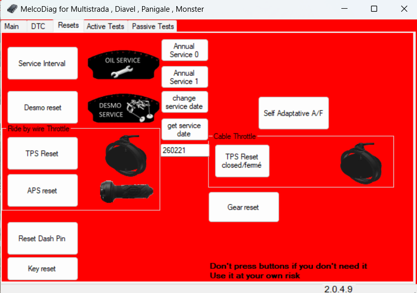

Greefy67
Posts: 7
Joined: Sat Feb 21, 2026 8:56 pm
Re: 2016 MTS 1200 DVT
Post by Greefy67 »
Screenshot 2026-02-21 212726.png (111.64 KiB) Viewed 4666 times

Does the picture not help?
yes it's good , i see you are well registered ,
but i also see you have a 10sw software which is giving me pain on MTS
