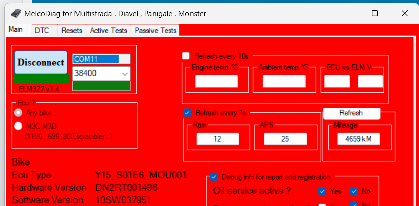

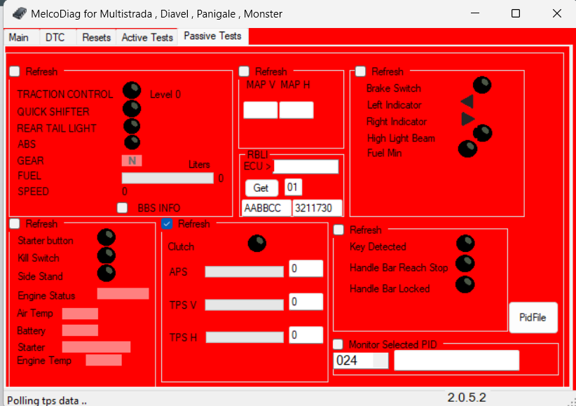

Hey JP, apologies for being offline last few days, lots of riding! Bike is still running great! Was able to just get it reconnected to MelcoDiag today. Just donated through paypal as well! Thanks again! I checked the APS value and it's reporting 0 regardless of throttle position on the "Passive Tests" tab. On the main tab the APS value is always showing 25 regardless of throttle and the rpm is all over the place with the ignition off.
