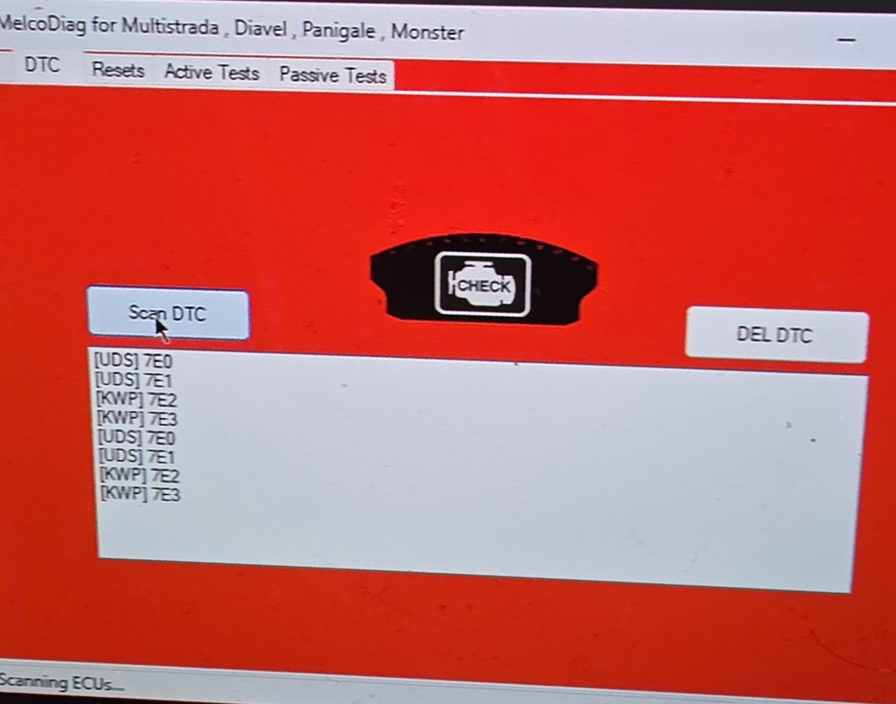

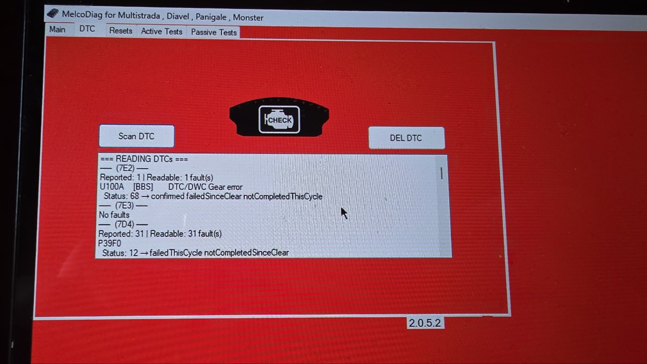

Hi! Was on business trip, sorry.
When i connect and press button:

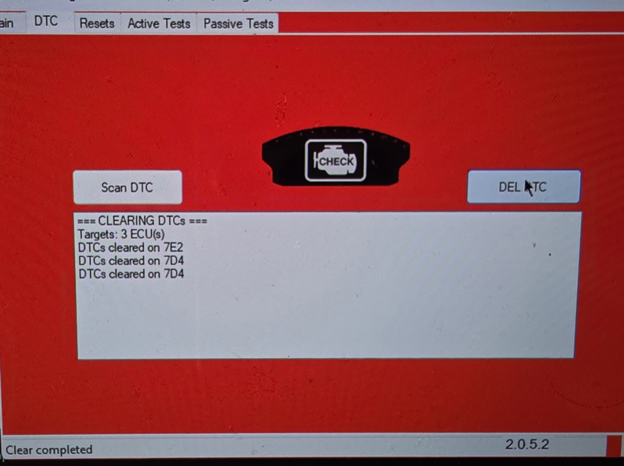

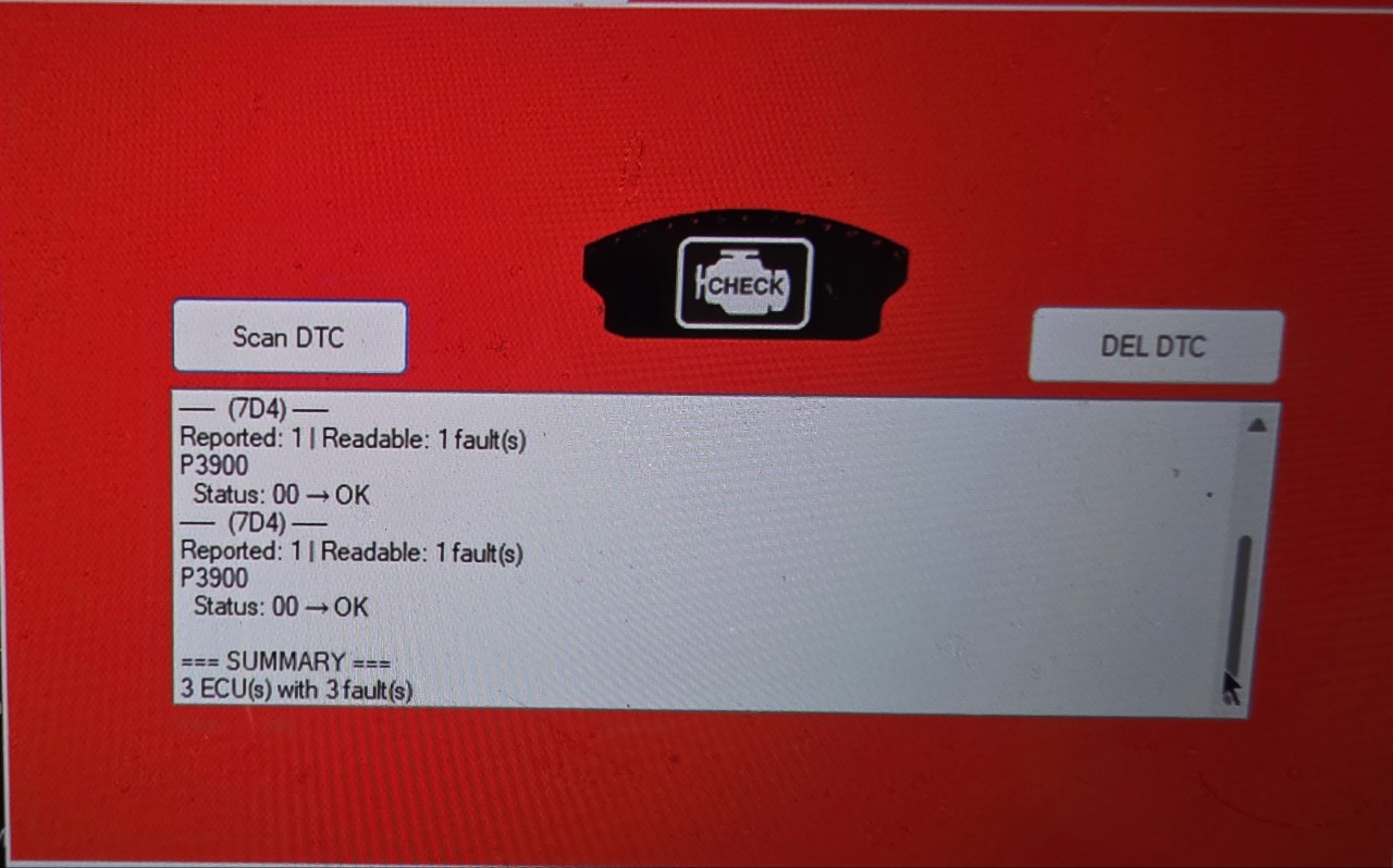

Post by Teo »

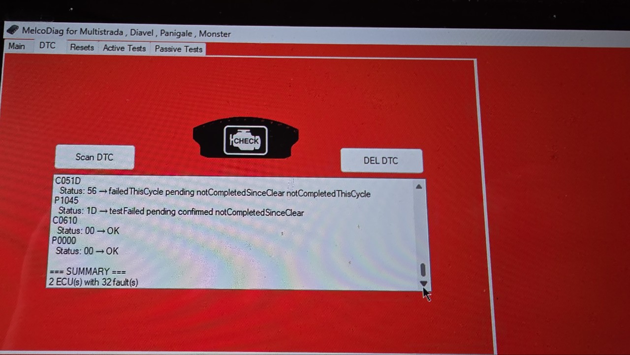

After that, i am cleaned DTS:
And i have got 32 DTS:
If you need, i have all 8 screenshots...
Posts: 1313
Re: Partial data read - only VIN
wow 32 faults on 7d4 , that's a lot .
after erased , you still have 1 ?
Post by Teo »
Some times 64 faults, but i did not foto its, after reload moto(turn off and turn on ignition) they are erased
Yes, 1 fault always returned and check engine still light.

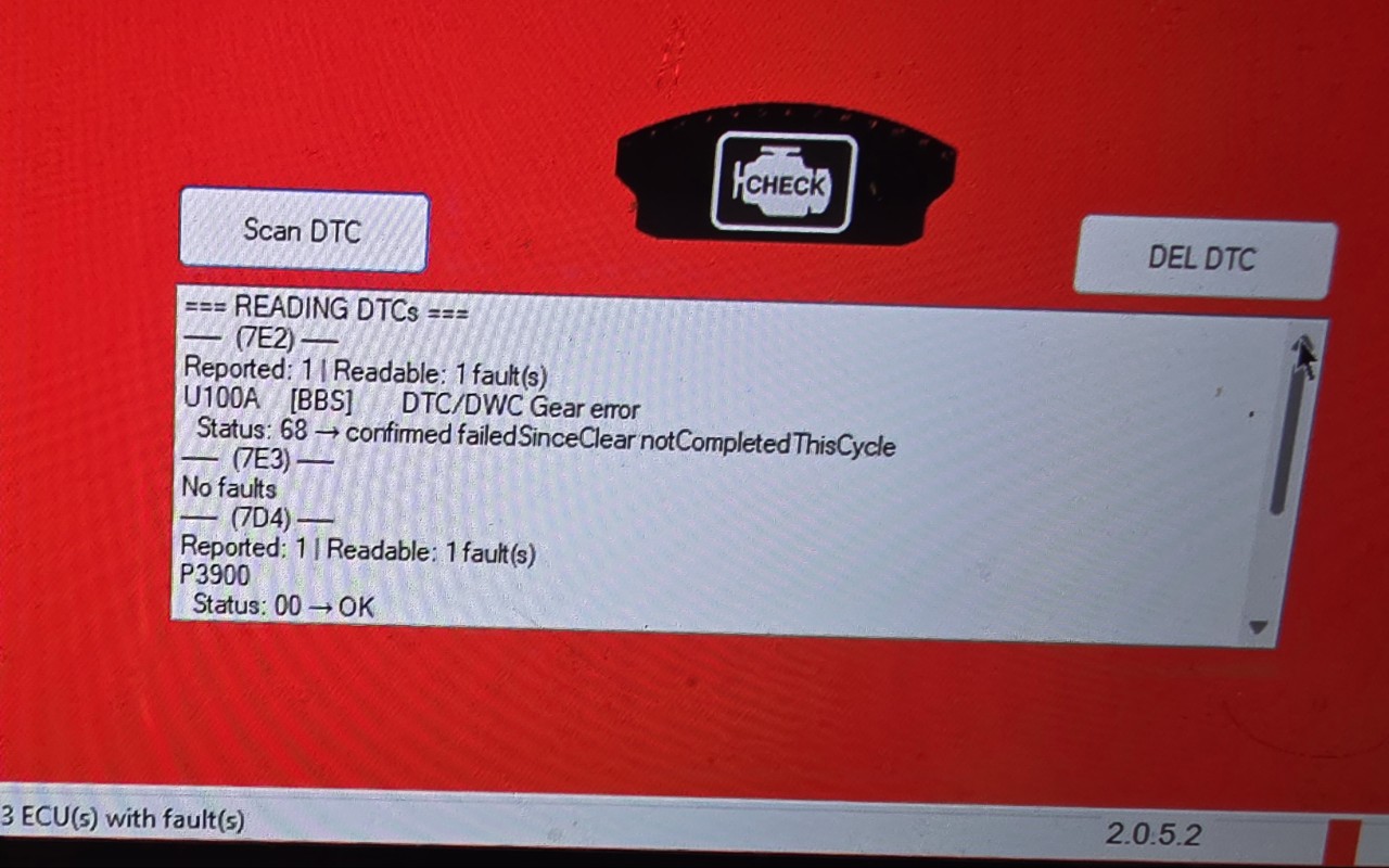

Posts: 1313
i guess the true fault is the u100a then

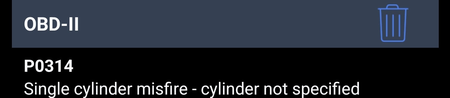

Post by Teo »
I used app for cars CarScaner it helped me erased fault. The fault was p0314:

Post by Teo »
It was only one fault in memory. p0314, and when i made test ride, it's returne
Posts: 1313
p0314 still not visible in jpdiag ?
