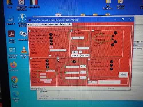

I tried to syncronis the TPS in my hyper 821 and i fount this result, after to push the TPS Reset:
After TPS Reset
After TPS Reset
After TPS Reset.jpg (213.51 KiB) Viewed 230 times
The sound of engine wasn't perfect when run

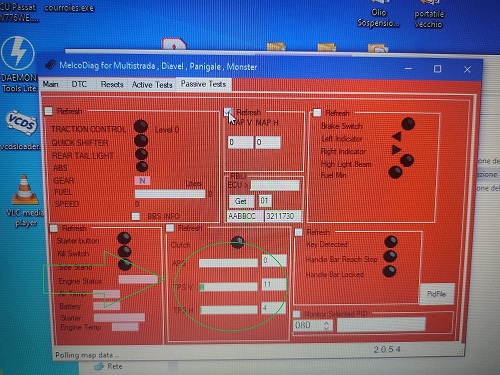

I check the MAP sensor (I rotate the gas for a little portion, please see the APS) and I didn't see nothing.
I remain with this porsion of gas for some second:
Control MAP and TPS
Control MAP and TPS
Control MAP and TPS.jpg (210.56 KiB) Viewed 230 times
I can some errors during reset TPS or when use the program?

Posts: 1469
Re: Reset MAP sensor and APS/TPS sensors
maybe those data haven't been tested with your bike yet .
you can help to add it by checking PID 024 and 080 with the monitor option.( coose a pid , and click on the value to pass it blue to be taken into accounty
aps shall move 0 to c8 , tps bytes shall be next the aps one
