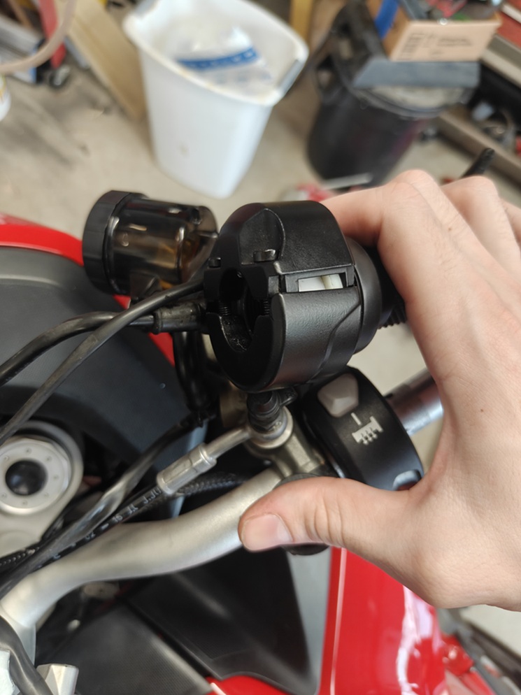

Hey JP. I did some more investigating. I wasn't able to poll pid 024 initially but eventually got it to read, still high throttle. Tried reading and resetting DTC a few times followed by TPS reset which triggered the DTC "TPS Self-calibration interrupted". Got frustrated and decided to look at the APS one final time.
For anyone reading this DO NOT TAKE APART THE APS/ THROTTLE GRIP. It is a nightmare to reassemble the spring once it pops out. I only did because I had done it in the past accidentally and wanted to double check that I put it back together correctly. I believe I did though may have shifted something out of place in the process.
Anyway, JP, I didn't completely disassemble the APS this time just loosened the screws as much as I could without it completely coming apart. This allowed me to close the throttle a bit more than normal. The 024 pid reading went from 5A down to 08. I reset the DTC and tried the TPS reset again. The message at the bottom of the MelcoDiag window said "reset failed" but I went to check DTC and there were 0 faults still
. I turned the ignition off and then back on and decided to try to start the bike again.
It still isn't idling properly but now it idles around 3k rpm so it can at least stay running for a bit though it doesn't sound happy. I'm not sure but I believe this means that the TPS was reset at least partially but it looks like now I need some way to reset the APS to actual 0. Any suggestions?
