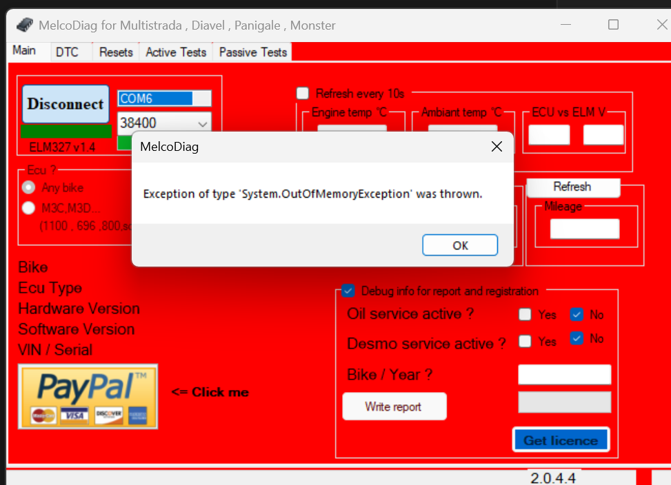

After clicking Connect, and a few seconds after Getting VIN step starts, I get "System.OutOfMemoryException" while trying to connect to my Hypermotard 821.
Ive tried 2 ELMs and 2 different laptops (both windows 11), Laptop is definitely not out of memory at that point.
Bike is on, without the engine running, port is correct, everything same as guides Ive seen where people got it to successfully connect.
Any ideas how to fix this?
Screenshot 2025-04-15 182605.png (156.61 KiB) Viewed 3147 times
Re: System.OutOfMemoryException while trying to connect to my Hypermotard 821
what your windows system language ?
you may need to instal .net framework 4.8

Thanks for the quick response.
Windows display language is English (United States)
I gave .net framework a download, but says framework 4.8 or later is already installed
can you delete this version and donwload it again ?
i'll try to catch the error , please report it
when error will popup there will be more details with the new version (same number but newer)

Hm, ok I downloaded melcodiag again and tried with that version.
I still got the same error, but after pressing OK I got a new popup saying No Vin found, press YES if 2011, NO if 2012. Bike is 2013 but I clicked 2012
Then it showed connected and allowed me to send a license request, which I did just 5 mins ago.
I also had it write a report if it's of any use. I didnt see any other option to report something

Here it is
Code: Select all
"File generated On 04-May-25 22:09:28"
"User Bike = Ducati Hypermotard 821 2013"
"Ecu = No ecu data"
"Softw = 12"
" vin 145A8F03
 vin  DATA
 vin 21a907F1A12
 vin 31A8F20 DATA
 vin 31A8F20 DATA
 vin 31A8F20 DATA
 vin 31A8F20 DATA
 vin 31A8F DATA
 vin 31A8FD07F1A12
018_0000520000000004
080_00118460000000C8
024_258E83CB00000000
020_0700FF03A8002E00
230_0000000000080000
300_00038400C50B0840
"121E30A4"
"Bike = 7"
im affraid you have an issue with the elm , or it's not connected to the right connector
