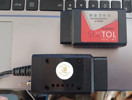

I have tried these two cables (see photo): one is a USB ELM327 v1.5 cable with a 4-pin Ducati adapter, and the other is a Bluetooth ELM327 v1.5 adapter. Both connect to the ECU, but when I try to activate an actuator or run an active test, MelcoDiag freezes or becomes unresponsive.
FTDI drivers are installed, the COM port is detected for the USB cable, but the issue is the same with both adapters.
Has anyone experienced this problem? Could it be related to the cable version or type? Would replacing it with another specific model help? Thanks for any advice!

it's not a big issue , and i don't think it's related to the elm.
it's certainly because there is an answer from ecu that it not handled yet , but that don't avoid the action to be completed
