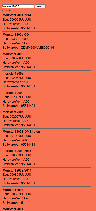

Good evening, I'm trying to get the data to activate the license but the connection only shows VIN and motorcycle type, why?
"File generated On 21/07/2025 23:40:21"
"Software version 2.0.4.5"
"Auto Detect Bike = Monster1200S"
"User Bike = 2014"
" vin 145A8F035A444D4D36303041414542303030373032
vin 7F1A12
vin 7F1A12
vin 7F1A12
9 PIDS active founds
018_0000460000000005
022_0000000000050000
024_0000000000123146
080_80000000000000C8
020_0600000130004300
100_024128427D45CF00
150_0000404B404B5629
160_000036368180C3C3
190_3800000000
"Vin = ZDMM600AAEB000702"
"9811344F"
ZDMM600AAEB000702
Thank's

Hi Jp, I tried with two other ELMs and nothing, same thing and same data, only VIN. How can I send you the rest? Would the ECU label be enough? Engine
Posts: 724
Re: Melcodiag activation Monster 1200s
i wouldn't suggest the no name elmv1.5 , we having a lot of trouble with
only elm cables are compatible and prefer the V1.4 , the command set is more complete
i don't need the missing data , you can still register , but i'm not sure that will works for some actions
