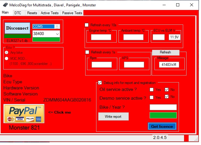

Hi, I have a 2016 Monster 821, and I'm trying to connect the diagnostic tool with a 4-pin OBD2 cable connected to an OBDLink LX Bluetooth.
I can't get it to give me all the motorcycle information.
Below is a screenshot of Melcodiag and the text it generates when I try to register the application.
I connect the OBDLink LX to the PC using a TPLink Bluetooth 5.3 USB adapter. I don't have an antivirus or firewall active.
I'd appreciate any help.
P.S. When I started testing, I found the motorcycle's diagnostic fuse was blown, and the OBDLink LX wouldn't turn on. I replaced it and it turned on. I don't know if it's important, but I'll let you know.

i would need a debug report instead the registration link
use create report button and send melcodiag report file content here
it's surprising the obdlink works in 38400, it's usually 115200 , but it's not your issue.

This is everything in the .debug file generated when you click the "write report" button:
"File generated On 04/08/2025 21:08:58"
"Software version 2.0.4.5"
"ELM version : ELM327 v1.4b"
"Auto Detect Bike = Monster 821"
"User Bike = 2016"
" vin 145A8F035A444D4D36303441414742303230383136
vin 7F1A12
vin 7F1A12
vin 7F1A12
16 PIDS active founds
020_02000001B0173E00
022_0000000000050000
024_0000000000173846
080_80004000000000C8
018_0000560000000001
120_7303010000000002
200_2000000000000000
620_2882C00000000000
240_0394C00000A89300
300_41048100A20B0000
230_0000000000080000
100_E141183F7540CF00
150_0000404B404B1A2A
160_000040408180C3C3
190_4000000000C99051
210_0000000000000000
"Vin = ZDMM604AAGB020816"
"84CBDAB5"
ZDMM604AAGB020816

what message do you have when you try to register the bike?
