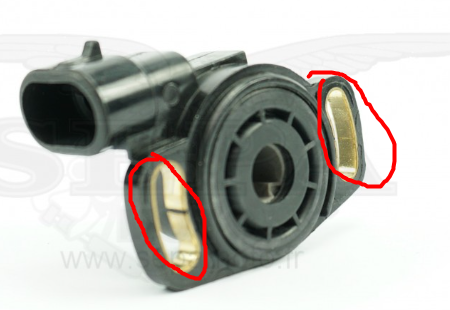

it's possible it's a mechanical tps reset .
you can look at your tps and see if the holding is adjustable or fixed
or
if it's fixed , i can be reset either by jpdiag , or if not possible , it's by pushing down a dash button while you switching on ignition
if it's adjustable , you can follow the workshop manual , there is a voltage to setwhile you turning it
or
Re: How to register
Thanks for the info. I'll take a look and do it. Not enough power at low engine speeds, power appears after 5000 rpm, like on an in-line engine. Is this solved by changing the co trimmer readings? Now it shows -15
