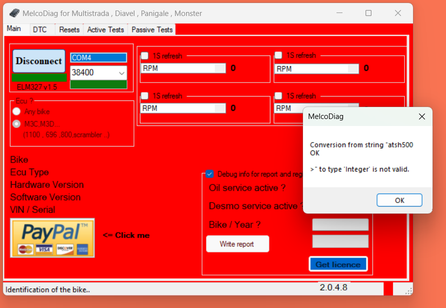

I am struggling to connect to my 2023 Ducati Scrambler (not the next-gen model). I've used the program before to reset my service, but I am currently getting the issue below. I get this error when I select MC3, when I choose anybike it will pull up some of my info, but will direct me to tick MC3.
Connection Error.png (128.76 KiB) Viewed 2522 times
Re: Integer is not valid
oh i see ,
i'm working on a new version which i hope fix this.
it's not yet finish , but the connection issue shoulb be better.
if you want to try it i can link you to the beta

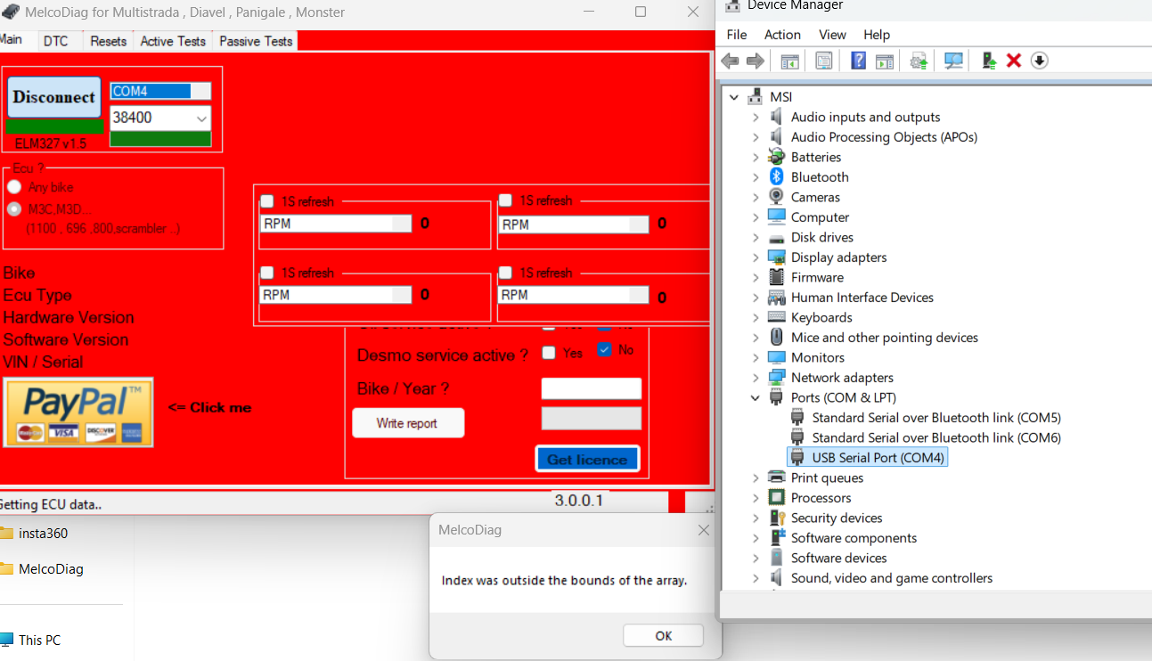

No luck
"Index was outside the bounds of the array"
Any other ideas? I've tried the other USB ports and all the bauds. Made sure my drivers were all good. I'm stumped.
MelcoDiag3 attempt.png (240.09 KiB) Viewed 2492 times
not really ,
i would need to do a remote session.
it looks like the ignition is off instead of on
debug report may help too
