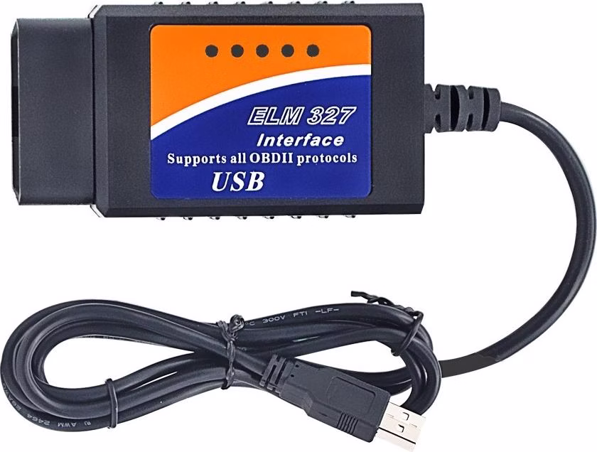

Re-bonjour JP
Est-ce que ce cable ELM327 sera compatible avec les Ducati?
Specifications:
Connection: USB
Baud Rate: 9600 or 38400
Indicator LEDs: OBD Tx/Rx , RS232 Tx/Rx , Power
Processor: ELM327
Voltage: 12V (integrated protection)
ISO 9141-2 (5 baud init, 10.4 kbaud)
ISO 14230-4 KWP (5 baud init, 10.4 kbaud)
ISO 14230-4 KWP (fast init, 10.4 kbaud)
ISO 15765-4 CAN (11 bit ID, 500 kbaud)
ISO 15765-4 CAN (29 bit ID, 500 kbaud)
ISO 15765-4 CAN (11 bit ID, 250 kbaud)
ISO 15765-4 CAN (29 bit ID, 250 kbaud)
SAE J1939
SAE J1850 PWM (Found on many Ford vehicles)
SAE J1850 VPW (Found on many GM vehicles)
