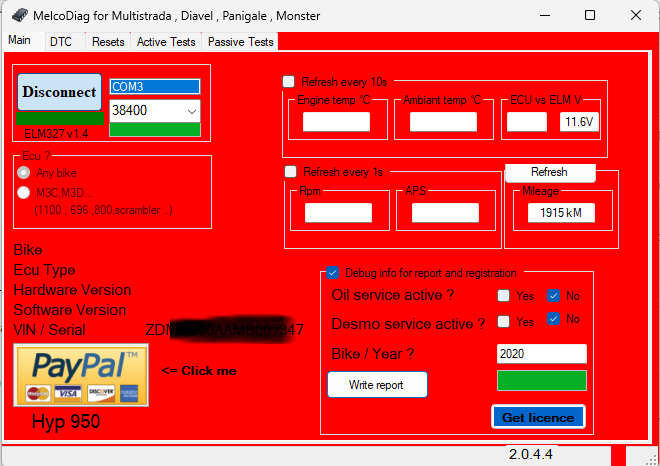

Does melcodiag work with Hypermotard 950? Can't get the licence.
Hyper950
Joined: Sun Mar 02, 2025 11:01 am
Post by Hyper950 »
Hello.
I'm using ELM327 V1.4 FT232RL 25K80
After connecting to bike its look like:
When trying get licence:

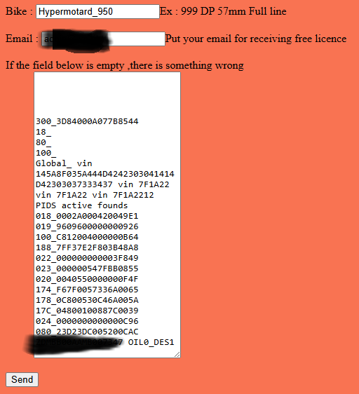

But after sending the sheet I got message:
Be sure you are using the right software and the rights cables for connecting to your bike , data are incomplete!
an m3c ecu use m3c9 software , a fuji ecu use melcodiag , a marelli 5am,5sm,59m,miu use jpdiag1

So. What I done wrong? I would like to reset a desmo service.

Re: Does melcodiag work with Hypermotard 950? Can't get the licence.
ok , in your case as the ecu model name is not grabbed
before you press send button on the register page , replace the 1 st empty line with the mention : no ecu data
once the field will be populated it shall continue the registration process

Thanks for your reply.
Problem solved.
Everything works fine.
All services have been reset correctly.
