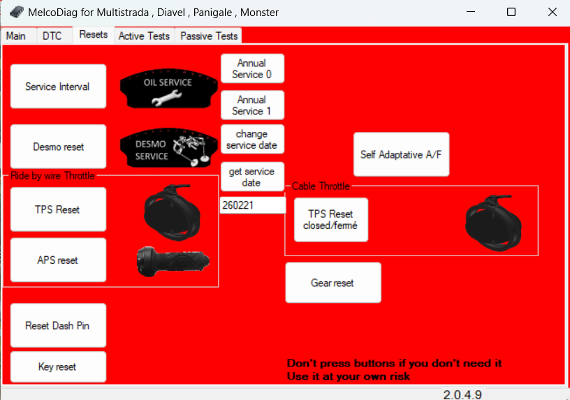

My screen looks different to the others I see.
I'll send a screenshot when I get home.
Screenshot 2026-02-21 212726.png (111.64 KiB) Viewed 4674 times
Re: 2016 MTS 1200 DVT
Posted: Mon Mar 02, 2026 9:21 pm
by Greefy67
Does the picture not help?
Posted: Tue Mar 03, 2026 5:18 pm
yes it's good , i see you are well registered ,
but i also see you have a 10sw software which is giving me pain on MTS
