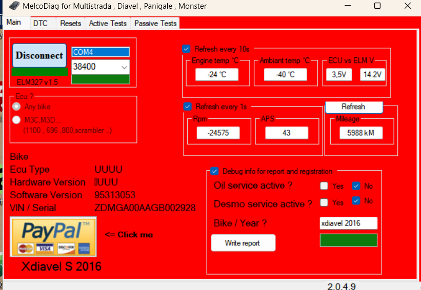

Tamino
Posts: 10
Joined: Sat Mar 07, 2026 1:51 pm
Re: xDiavel 2017 Reads but not resetting
Post by Tamino »
Check your software version. The ones that start with 10WS seem to cause problems with Melcodiag. If you look at my screenshot, you’ll see that I have a different software version, and my bike is from 2016, quite close to yours.
