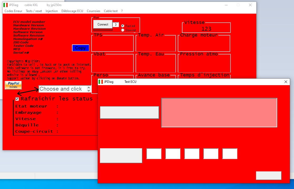

Hello everyone!
I have a problem with font display on buttons in the program.
I’m using Windows 10. I’ve tried installing the Italian language pack in the input language settings, and the EU pack is also installed — but nothing helps. I’m running the program as an administrator.

so i guess you didn't use the setup to install the files and it miss some directories .
you should create a lang directory in the jpdiag folder and put all languages ini files inside of it

jpl250rs wrote: Fri Apr 10, 2026 3:40 pm so i guess you didn't use the setup to install the files and it miss some directories .
Thank you, Sir!!! It really works! The folder was missed! Thank you again!
