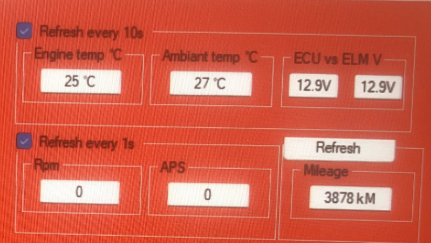

So i have not yet tried to remove the M sensor plugs yet, work commitments. But what i have noticed is with the hot days the bike has become hard to start, just turning over and when it did start would not idle until warm, some times the engine would cut out when approaching a round about. This is different to the colder months, at least it would start easy and idle until warm.
After connecting Melco diag i recorded the below M sensor readings, either the V or H remained at 0, is this an indication of a faulty sensor?
Engine was not started, just turned bike on.
Screenshot 2026-05-27 184255.png (23.82 KiB) Viewed 13139 times
Screenshot 2026-05-27 184425.png (44.59 KiB) Viewed 13139 times
Screenshot 2026-05-27 185047.png (193.89 KiB) Viewed 13139 times

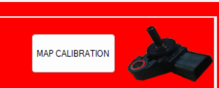

After replacing the M sensor would i need use the calibration function? and how would this work? is it safe, would i delete any thing?
Screenshot 2026-05-27 190034.png (25.91 KiB) Viewed 13138 times

you should check sensor engine running.
if it stay on 0 our 254-255 the the sensor is dead.
if you need to replace MAP sensor, yes a reset could be usefull even if i never saw a big difference doing it
