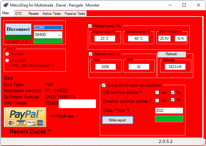

The problem is that the decoded live data are clearly incorrect. For example, with the engine not running MelcoDiag displayed approximately:
RPM: 8206
AFR: 42
ECU voltage: 25.5 V
Ambient temperature: -40 °C
Mileage: 3423 km

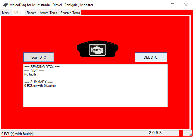

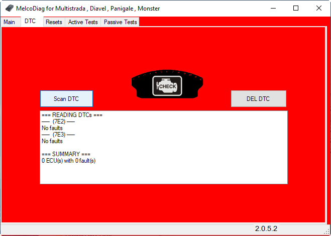

DTC scanning also communicates with addresses 7E0, 7E1, 7E2 and 7E3, but finishes with:
No faults / 0 ECU(s) with 0 fault(s)

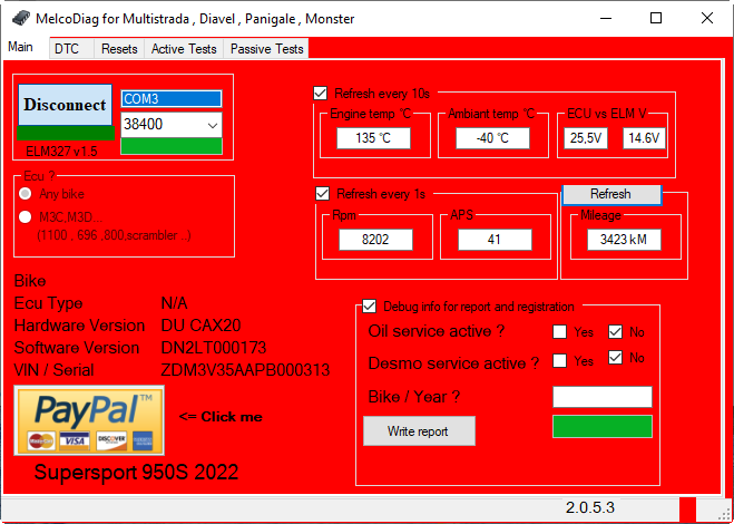

Thanks for fast response, I tried the version 2.0.5.3 and motorcycle model is great but data looks very strange, and I still have unknown ECU, is it somehow possible to solve it?
16. 8.png (18.61 KiB) Viewed 62 times

Ahh ok. So anyway it works? It reads the data from ecu like errors etc even if theres written unknown (N/A) ecu?
Re: Ducati SuperSport 950 S MY2022 – M4C – Bike not recognized / wrong live data / DTC not read
all functions are separated , the vin is only the entry point
