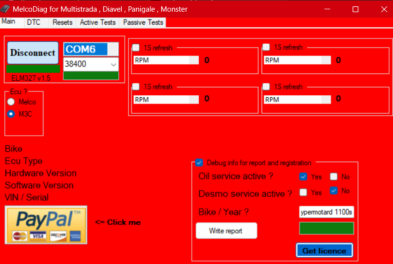

Hello, while trying to register for a license, I'm receiving an incorrect ECU information error. I have tried using other software provided on the USB like JPDiag, but those won't connect ( Yes, I set up the correct COM and driver's are downloaded), and tried using the KKL409 reader, but that as well won't connect. The only setup that does connect is the ELM327 with the 4-prong adapter using ELM-supported software. When I connect the ELM to the bike after letting it complete its startup cycle (The Dash lighting up and flashing the Ducati logo), I successfully connect, but the ECU information isn't being generated correctly. I have tried matching the adapter and the software provided on the USB in various ways
Adapters I currently have https://www.ebay.com/itm/224395992105
Software that works with the bike and generates the ECU info:
M3C9
MelcoDiag
Yes, I understand that those are the two software programs compatible with the ELM adapter, but ELM works, and KKL409 simply doesn't.
ECU info Generated:
300_0000000000000000
Global_3 PIDS active founds 03C_3C00000000000000 00C_3C00000000000000 CAN_ ERROR
OIL1_DES0
The Port I connected too, The 3 prong port doesn't provide information only this one does.

The Software I used
The Software I used
SS Software.png (91.8 KiB) Viewed 29645 times

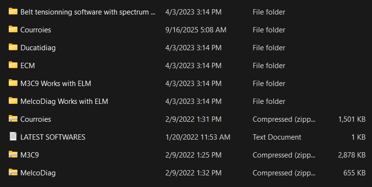

There is not 3-prong OBD2 port on the 2008 model, which was confirmed by the dealership. The software I used was M3C9 and MelcoDiag because they are the only ones that can connect to the bike without giving an error saying " can't innit". If I use any other software, it will not let me connect to the bike.
These are the software that I have access too
ss ava software.png (33.38 KiB) Viewed 29639 times

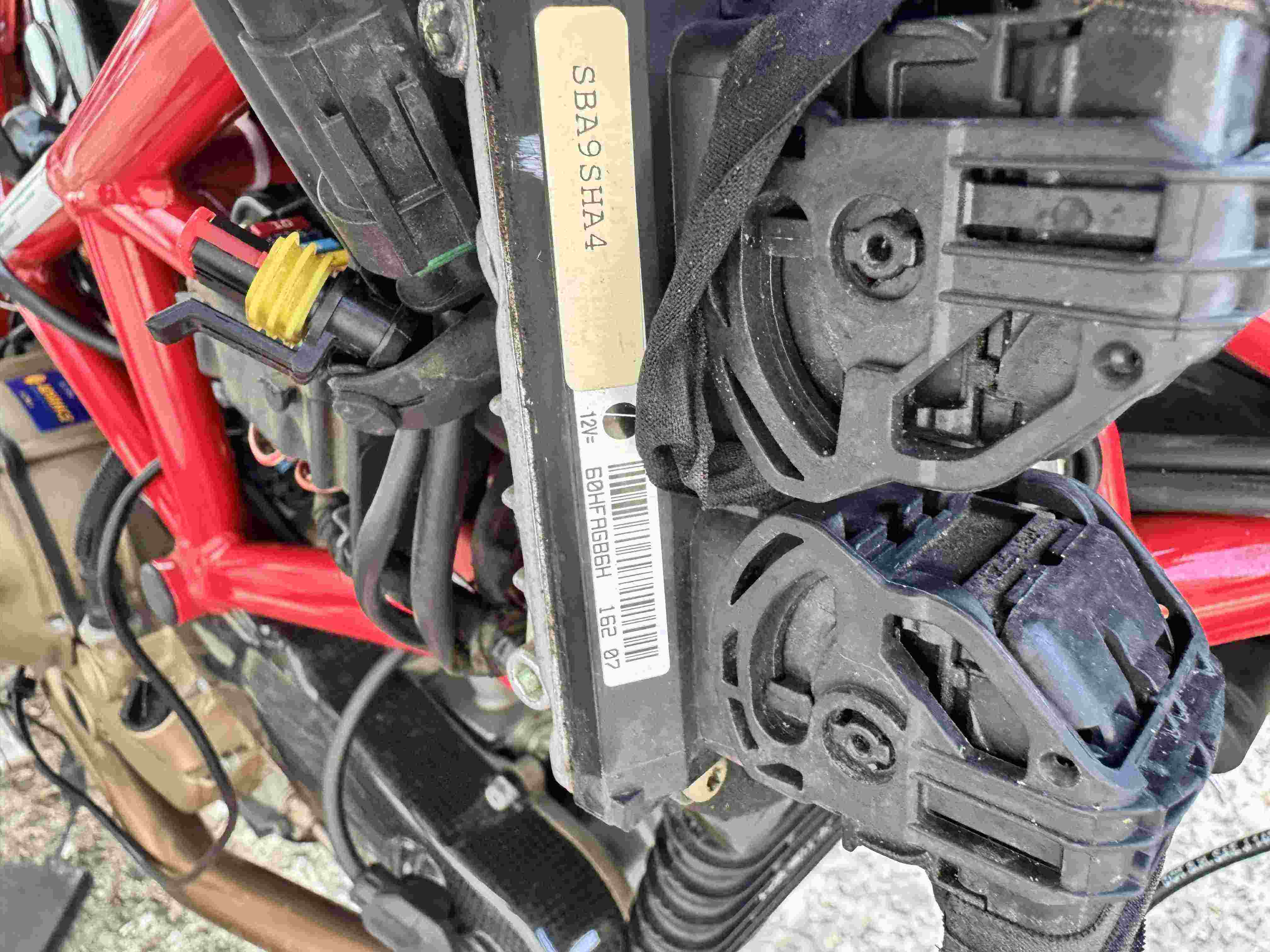

I have a Ducati Hypermotard 1100s, it is not an EVO, my VIN confirms it's an S model as well
SS ECU 2.jpg (243.02 KiB) Viewed 29626 times
Re: Bad Information From ECU, DUCATI HYPERMOTARD 1100S 2008.
So it’s the 5am, 100% you have a 3 pin connector near battery I see it on your picture

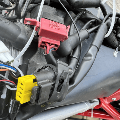

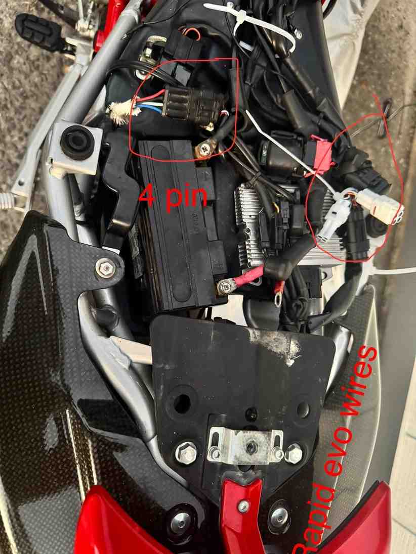

The ECU is a IAW 5AM 2, Their is not a 3-pin connector. The connectors you are spotting are from an EVO rapid kit I'm going to install after I reset the TPS And their is only a 4 pin connector next to the battery
Look better ,you will find a pin 3 pin connector with 2 wires
This is the only way to make it works
Your bike is standard like all other non evo models

The 3-pin connector on a 2008 HM1100S comes off the ECU directly. I believe the 4-pin wire, which is located near the tail, is for the DDA only.
You can see the 3-pin connector here in the bottom left hand corner of the image:
