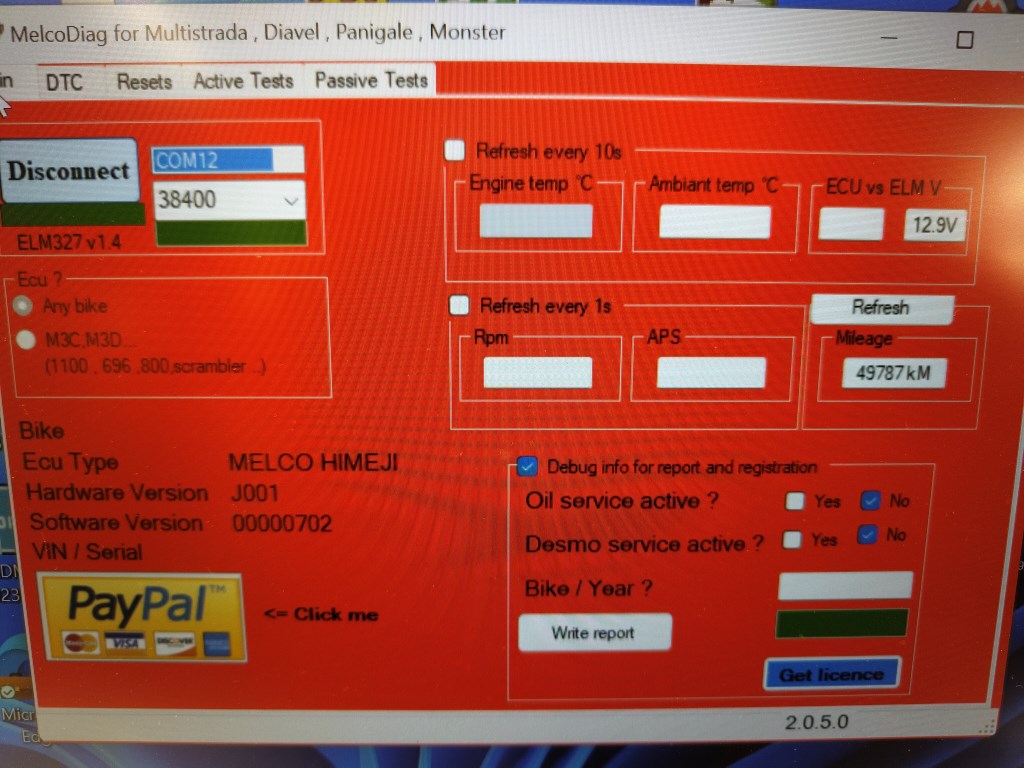

Thanks for the quick response. I tryed that software version. This did not give "System.OutOfMemoryException error", but did not find the vin number. Got the same notification as before "no vin found, press YES if 2011, NO if 2012.".
Does it have an effect when this version has "not registered" status? Below is the debug list.
"User Bike = Diavel 2015"
"Ecu = MELCO HIMEJI "
"Hardw = J001"
"Softw = 00000702"
5 PIDS active founds
080_04000600000000C8
020_01000000BE000000
018_0000160000000007
022_0000000000040000
240_6493C00000A8A200
"0E75F6E9"
"Bike = 7"
"Hardw = J001"
"Softw = 00000702"
"0E75F6E9"
"Bike = 7"

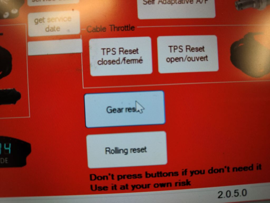

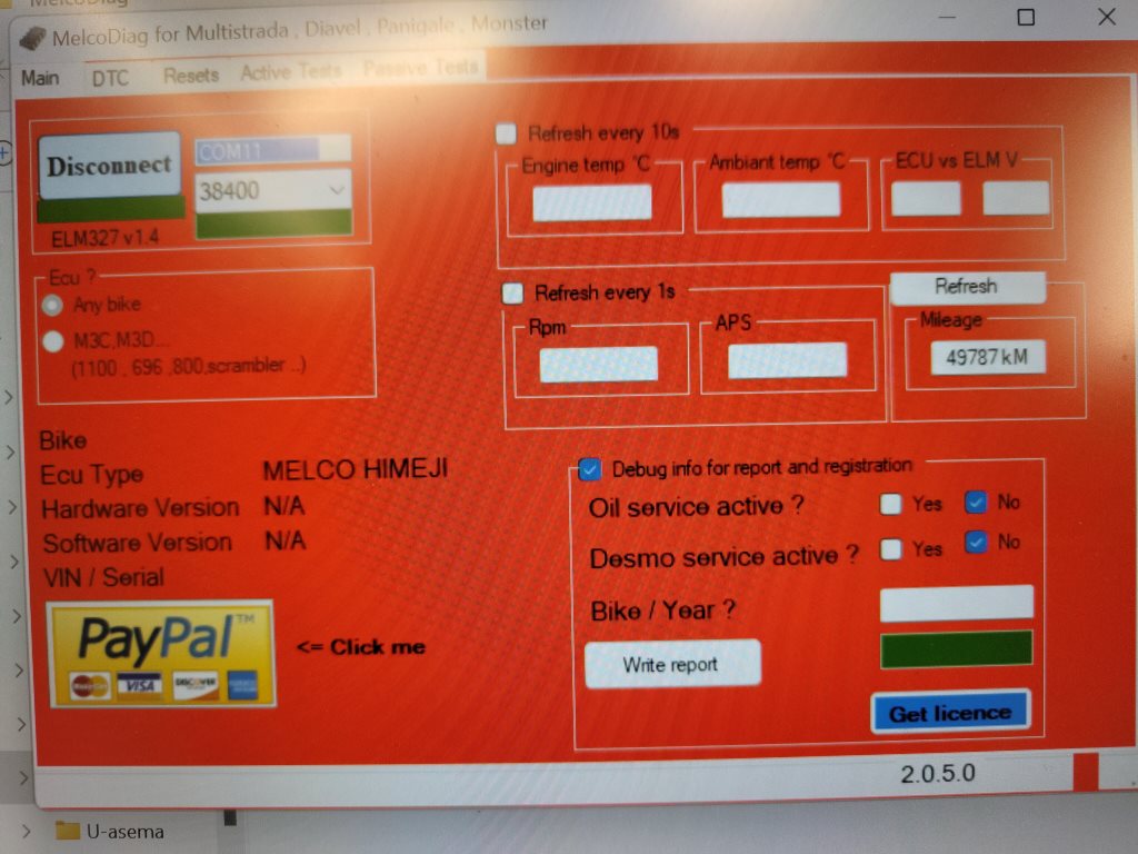

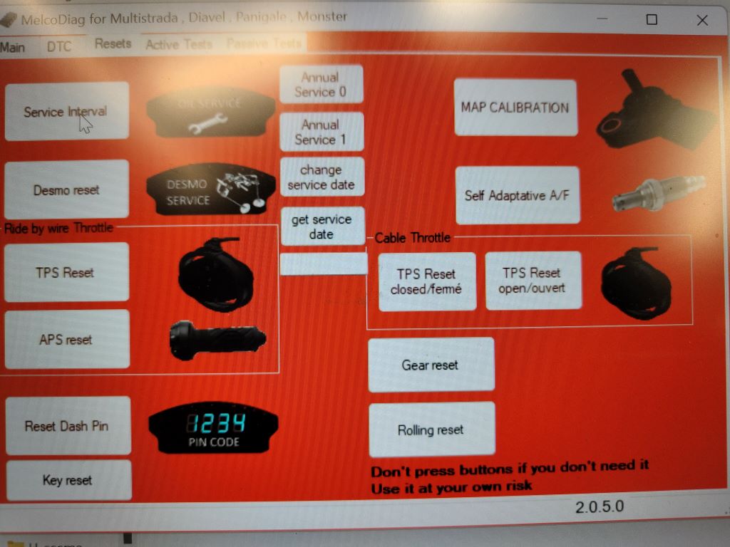

Re: System.OutOfMemoryException problem with Diavel 1200
I tried and chose the 2011 model. The hardware and software version shows n/a.
The service menus cannot be selected and they do not turn blue like in the gear reset example.
