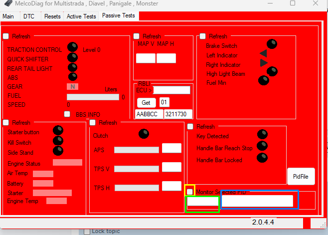

the reason you don't see the TPS H , may coming it's notthe same format as the 899 i used to developp this fonction
you can check if you follow the below process
- tick monitor ( the yellow )
- select PID 080 you need to scroll untill you find it , then click on it to select it , it'll become underligned in blue
- check in the blue square if you see a byte changing when you actionnate the throttle ( full throttle shall show C8
you can do the same process on pid 024 too
tell me what to see , i will improve mecodiag accordingly

Re: Tps reset issue / how to debug passive reading
ok thank you, i can improve melcodiag only with user help as you are doing , cause i don't have the specs neither the bike to debug by myself
so we'll focus on PId 080
if you don't move throttle , there may have some value still changing too , you can dsicard those ones.
in the 8 bytes you are seeing 01 02 03 04 05 06 07 08
which ones you are sure they belong to throttle value ?
you can note the value at iddle , mid opening , and full throttle
i'm expecting 2 bytes changing
