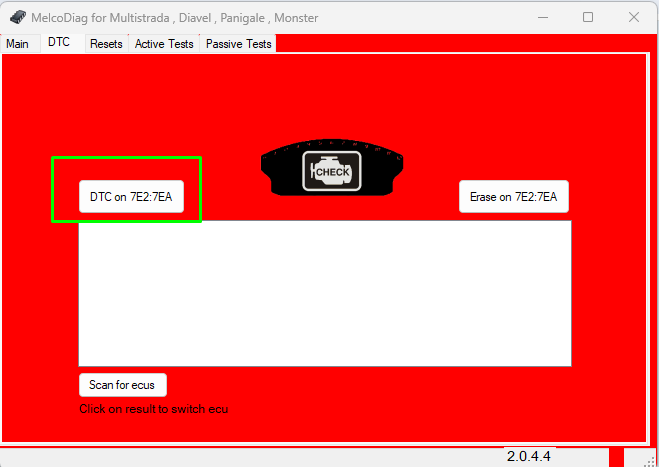

Re: Panigale 959, ECU Connection /DTC Error
try to press DTC button before doing an ecu scan , you will get those stored on 7e2
after the scan , i need to fix something avoiding to read dtc on each ecu
it's normal you have nothing if you tick m3c, you don't have this kind of ecu

When I press „DTC on 7E2:7ea“ i will get „No answer on 7E2“
Or which DTc Button do you mean?
Posts: 1238
this one
go straight foward on this button when you start melcodiag without pressing ecu scan button
please also your debug report it may help
