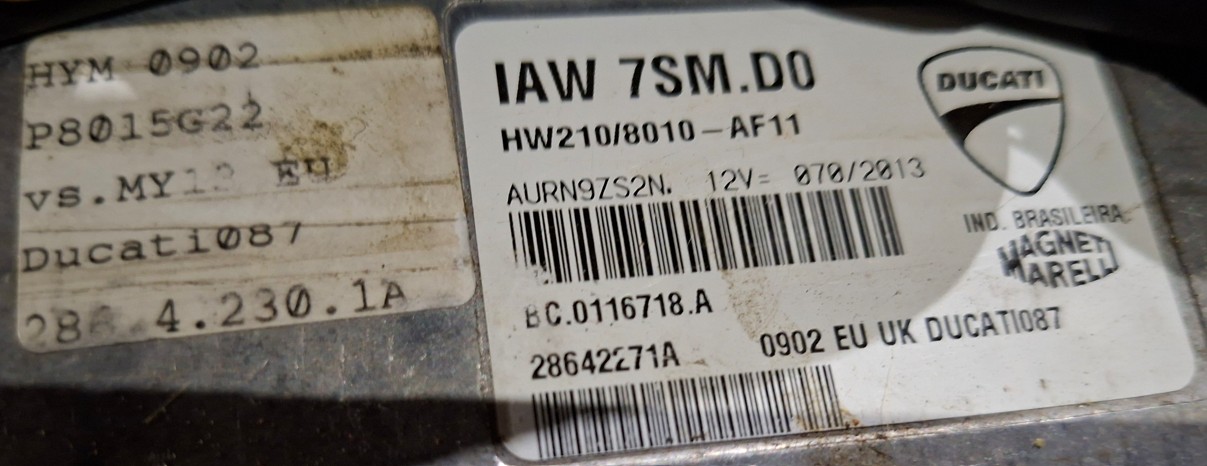

Hi, I have a 2013 European Hypermotard 821 with IAW 7SM.D0, HW210/8010-AF11, Ducati P/N 28642271A and P8015G22 printed on the ECU.

Could you please tell me whether the ECU identification/software information is unavailable from this ECU, or whether MelcoDiag simply doesn't decode the relevant response for this 2013 7SM calibration?
I am particularly interested in determining the actual calibration/software installed in the ECU, because the dashboard displays HYPERSTRADA even though the motorcycle is a Hypermotard. I would like to establish whether the engine ECU is running a Hypermotard or Hyperstrada calibration.
