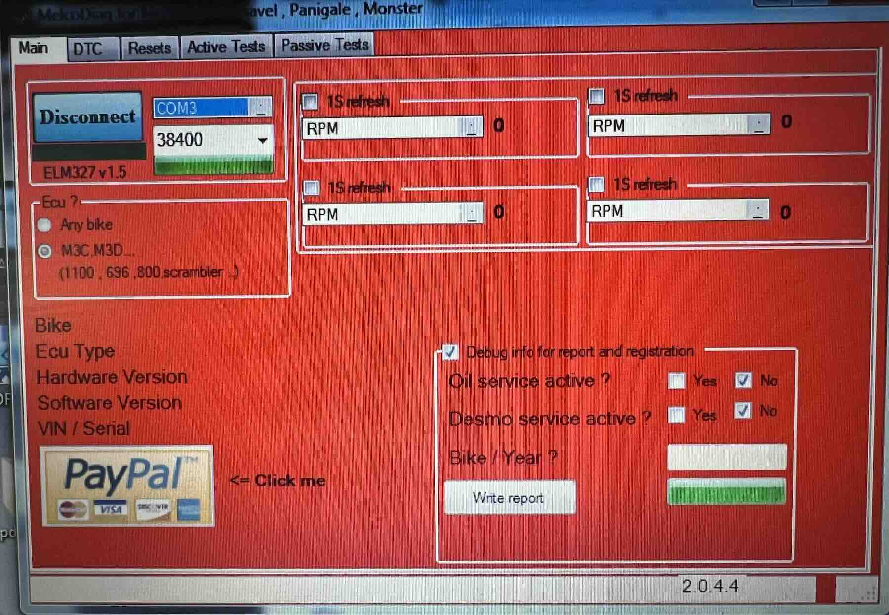

unfortunately I cannot connect to my Monster 1200S 2014 correctly.
I think, the connection to the cable is correct, since it will be displayed once I click on the connect button.
Afterwards the program tries to read VIN number, but cannot find it. A window pops up with the question, whether the bike is 2011 or 2012.
Eather way there will be no info's displayed afterwards.
I tried with "any bike" and "m3c" settings as well.
This is what I get after clicking "write report"
"File generated On 18.04.2025 10:43:12"
"User Bike = Monster 1200S / 2014"
"Hardw =
"Softw = D"
" vin OPPED
vin OPPED
vin OPPED
vin OPPED
vin OPPED
vin OPPED
vin OPPED
vin OPPED
vin OPPED
vin OPPED
vin OPPED
vin OPPED
1 PIDS active founds
STO_PPED
"7610B378"
"Bike = 7"
Would be great if you could tell me that I'm doing wrong.
Thanks!

your elm is not compatible
it keeps saying "stopped"
prefer an elm v1.4 or buy it from lonelec,obdauto, bmdiag etc..

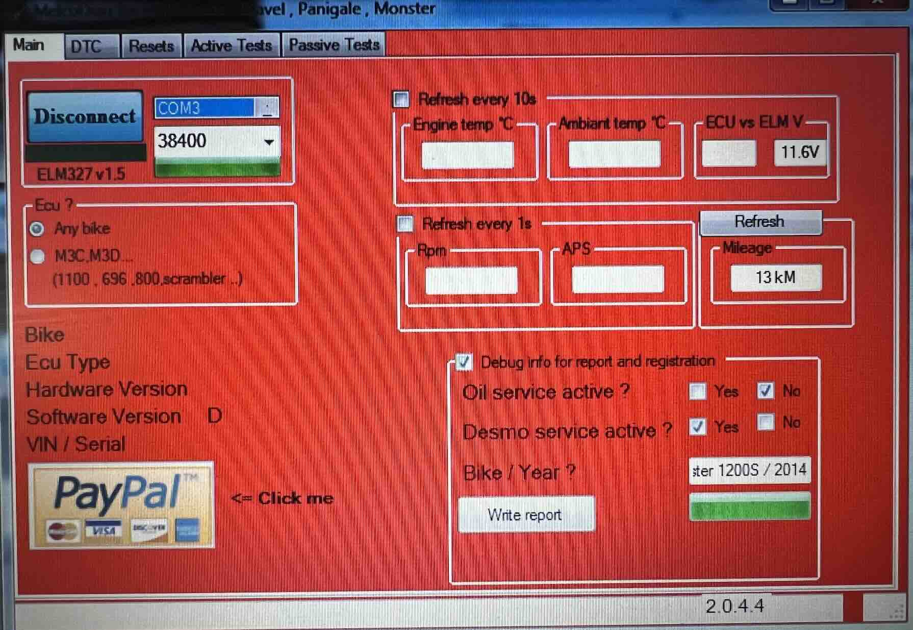

Ah thanks, i thought the cable was ok…
Could you recommend one?
Re: No VIN/ECU Monster 1200S 2014
I think it worked now.

Unfortunately I forgot to click "register" at the first time. Afterwards the software would not recognize Hardware and Software...
I still sent the register request.
No, i just bought another 1.5 cable from amazon and it worked.

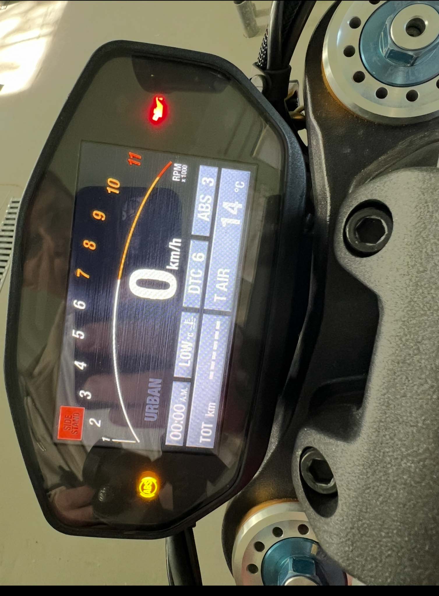

Do you know if it is possible to restore the total km counter?
Somehow it only shows blinking ————

i think it will be resynch automatically after few kilometers
Unfortunately not, been riding like this the whole past year
oh ,and you can see the mileage in melcodiag ?
