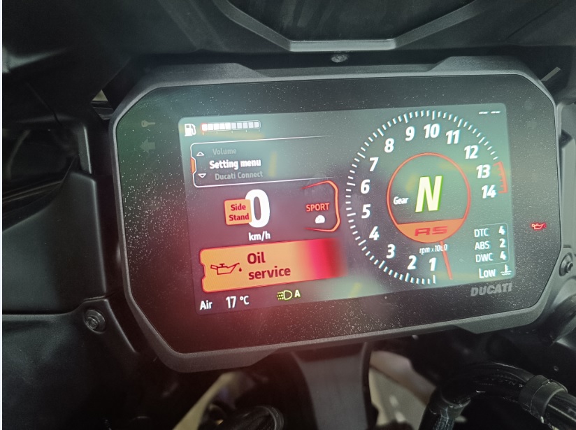

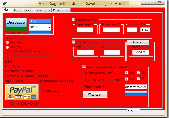

Hello. I have problem with reset oil servise.
I have lisense for this bike, but when i click button to reset, after bike dont reset oil servise.
I add debug file, and photo monitor.
"File generated On 11.05.2025 13:08:34"
"Auto Detect Bike = If your bike is not a 2010 to 2012 made ,please contact jpl250rs with your VIN and model bike"
"User Bike = multistrada v4rs/2024"
"Hardw = """
"Softw = 22000000"
" vin 145A8F035A444D3841303041415242303030303439
15 PIDS active founds
024_00000000000008E2
084_19A226122600563F
330_145400001DB80DD5
020_00407710680044FF
018_0002A00063004843
019_960960000000083B
08A_00000000000008E2
080_19A226C00520082D
100_C80205F060000739
022_000000000003F5C8
023_000000FC7FE7051E
088_40FF430000000B33
184_7C978F3F000005F3
188_7FF77C77801F458D
18C_7FFB7FFF800B0
"Vin = ZDM8A00AARB000049"
"DTC = 037F181100000000 037F181100000000037F181100000000 037F181100000000037F181100000000037F181100000000 037F181100000000 037F181100000000037F181100000000 037F181100000000037F181100000000037F181100000000"
"BCEA8FFB"
ZDM8A00AARB000049
ZDM8A00AARB000049
Re: Multistrada V4 RS
ok i patch mecodiag and add your model , you can re download it , and try again

Thank you! When release new version?
since i replied you yesterday

Hello. i now check reset service, and no.... I undertstand why....
