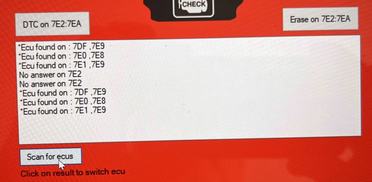

Refer to the attached photo. Is this a normal result for my bike?
Re: ECU scanning result 2015 Ducati Diavel Carbon
Yes it’s normal
But the elm has some issues for switching from an ecu to an other
You can try to press dtc on 7e2 without doing the scan

That worked! Thank you.
