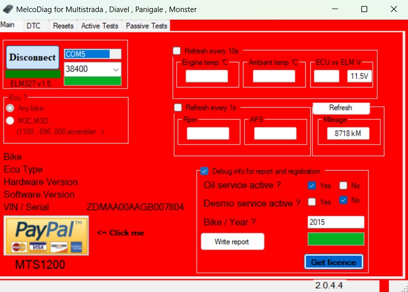

Re: New license
Hi JP,
i tried with another cable (USB adapter) but i have the same reply.
The VIN and the motor type are detected, but no ECU type or software or version.
Here is the screenshot of the app:
download/file.php?mode=view&id=73&sid=6 ... a830e080a2
When i click on the blue button for the license the detected data is as follow:

From this, you can understand the problem?
Thanks
Christian

Re: New license
you an post the debug report instead of a pieces of the registration link
but i can see you are using an elm V1.5 , i hope it's not this that is causing troubles
