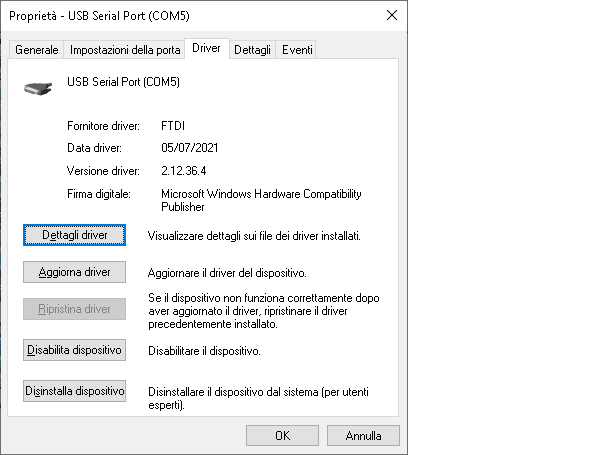

The JPDiag28c.ini file has last modified date 2020 and it worked, I noticed though that the driver version is 2021 and I think is the one from the manufacturer, anyway with elm I can only check the flag for 9600 or uncheck for 38400, which one should I use? And with fast or slow init? A log to see what's going on would be helpful but I didnt' find it.

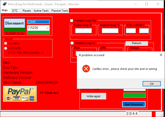

I get thie attached error, I then tried jpdiag and it works so no elm or wiring problem
Re: JPDiag gets stuck on connecting
yes the 2 protocols are different .
but if elm stay connected , you can go to passive tab and grab the pid list
