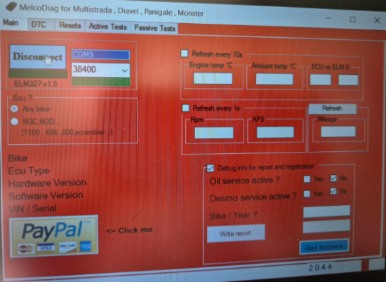

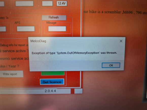

I have been trying to get a licence for Melcodiag for my Multistrada 1200S 2011.
I have connected using a ELM 321 1.5 cable, but the softwared doesn't seem to connect, and the information in the window is rejected by the message system when I try to send it for a licence.
I have tried 2011 and 2012. I have changed the com port speed.
I have attached some images showing the kind of thing I have got.
I want to reset the PIN, and to check DTC's

Re: Multistrada 1200S 2011 Need Licence
have you downloaded recently ?
the com speed is 38400 for a conventionnal ELM
can you post your debug report ?
the com speed is ok , but you get no data from the ecu , the possible reasons could be :
- you dind't switch on ignition
- you are not connected on the diagnosis port
- your elm is not compatible ( we having problem with some v1.5 as yours)
Just to update this thread.
I bought another ELM cable.
This time it worked.
Thanks for the advice.
