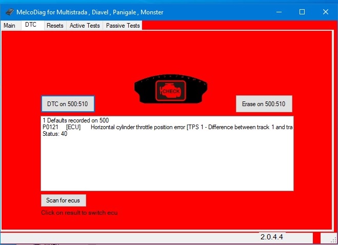

This afternoon i saw with Melcodiag, the error below:

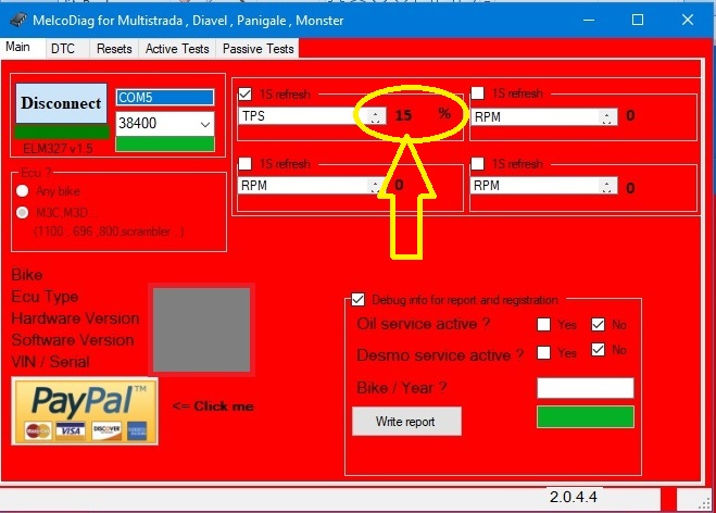

When i whatched it, I whatched the value and it is 15%(please see the yellow row):
Valore del TPS.jpg (94.34 KiB) Viewed 5539 times
well, i went with the reset TPS but, after i touched the relative button, i didn't see nothing. The TPS remain 15% and i still have the same error.
I remake the sequence and after i close the MelcoDiag but nothing. when i restart the engine, nothing. The same value and error.
I made the same thing with M3C9 program but i have the same result.
Can we help me? do i make some errors?
Thanks guys,
Luca

When i selected the field TPS (please see the last image) i read 15% when the throttle are in minimum position. If i remain in this field and i rotate the throttle i see an increase of value. i arrived around 117% (It was the end of throttle rotation)..
After this description I hope to describe that your program work well but the TPS remain at the 15% at minimum position forever also after make the TPS reset with your button in Melcodiag..
I make a mistake during the TPS process?

i tried to test in this week.
I control the % in the full throttle position. I saw the value 100% (when i arrived in this position i saw that i had another small part of gas wire but the throttle doesn't misure this extra lenght).
After i tested the reset TPS, higlighted in blues the field TPS. I touched the button "Reset TPS" and after i controlled in the correct field but it remain at the value 15%.
I disconnect and reconnect but the value didn't change.
Another test i tried to press the other two buttons. In sequence "SELF ADAPTIVE A/F" and after "TPS Reset Closed" (in the mean time i saw an OK over green square in the right angle below the window of program). immediatly i controlled in the main menù the TPS and i saw the 15% of value (it remain the same).
I did some mistake? what's the problem that i don't correct the value?
Thanks,
Luca
