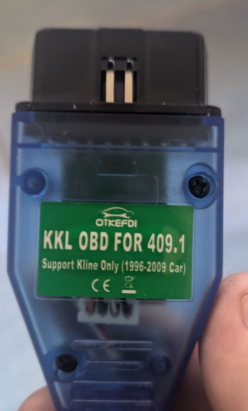

Hi, I'm getting this error while trying to connect to my ecu:
CANT INIT ELM!
check your setting COM and your COM speed
im quite sure I have installed the correct FTDI CABLE DRIVER (CDM20824)
maybe i got wrong cable:
any help WILL BE VERY APPRECIATED!!!
Immagine WhatsApp 2025-09-11 ore 19.45.42_a2439cd8.jpg (62.89 KiB) Viewed 723 times
Re: CANT INIT ELM error
a kkl cable isnot an elm
you need an elm327 for melcodiag or m36c9
