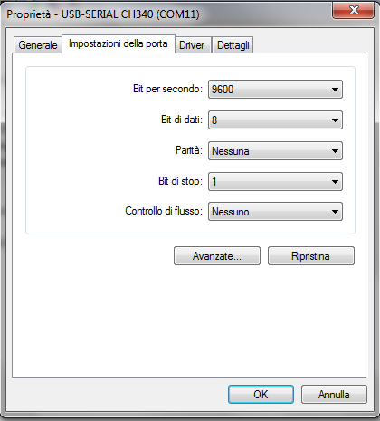

Hello, thanks for replying so fast. In the first place I started by following a tutorial that suggested to purchase that specific product and those drivers for an Hypermotard. I discovered soon enough that every bike is different. I am having troubles identifying the proper device that could work with my Panigale. In the past I also purchased this product: https://it.aliexpress.com/item/10050069 ... pt=glo2ita; Could this work instead?
Anyway, would appreciate any help regarding the kind of hardware that can work with my 2019 Panigale, and I'll also attach some screenshots, I hope that's what you mean with "comport section", thanks.

Re: Panigale V2 2019 - Can't init Elm error
this cable can't works.
your bike use the can bus for the diag , only an elm can handle the can bus.
the cable you bough is a kkl for serial line communcation
Have you made the report with the elm cable ?
Melcodiag can’t find it because
- comport isn’t right
- com speed ain’t right
- the cable is it an elm
