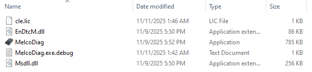

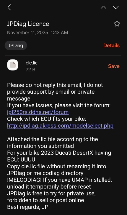

Thank you for the response JP. I did register before attempting to reset and posting here. When connected and using the program the license button does not show anymore because I have the license and it is in the proper directory. The buttons are grey but they have a blue outline and I can click them. However I get the error tone.
Please let me know if I have misunderstood. What actions should I take next?
Here is a screenshot of the email with the license and showing it is in the directory.

c'est bon dans ta capture d'ecran mais pourquoi tu as
"lic not found"
ca veut dire le fichier cle.lic n'ertait pas là quand tu as fait ce rapport ou que le logiciel ne peut pas le voir .
