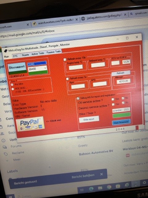

I understand now that the previous text was not the correct report. I tried to generate the report as you described, but I’m running into the following behavior:
AnyBike mode
When I select AnyBike, the system shows “no ECU data”.
I then press Write Report.
After that, when I press Get a licence and fill in my details, I get an error message saying:
“Error: missing some information.”
Because of this, I’m not able to generate or send a proper debug report in AnyBike mode.

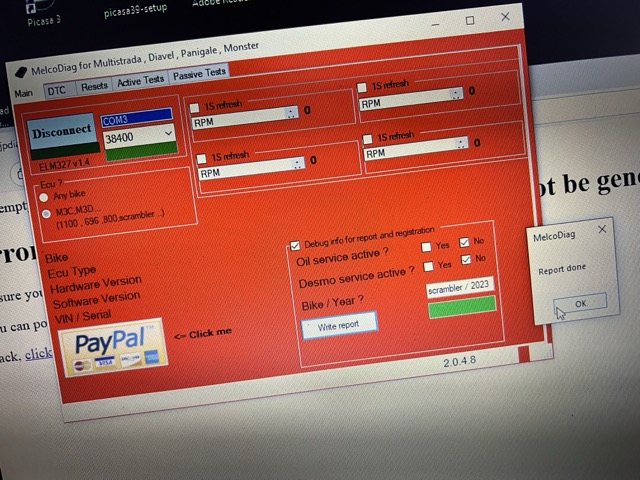

M3C / M3D mode
When I select M3C / M3D and press Write Report, I get the message “Report done”.
However, after that, the Get a licence button disappears.
In this mode, I am able to press the service interval reset buttons, but nothing actually happens:
the service warning remains on the dashboard
no confirmation or error message is shown
I have attached some screenshots showing exactly what I see in both modes.
