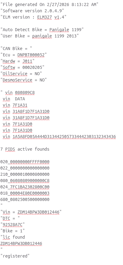

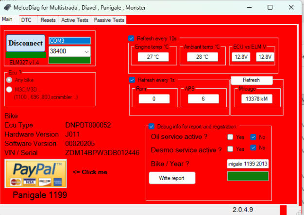

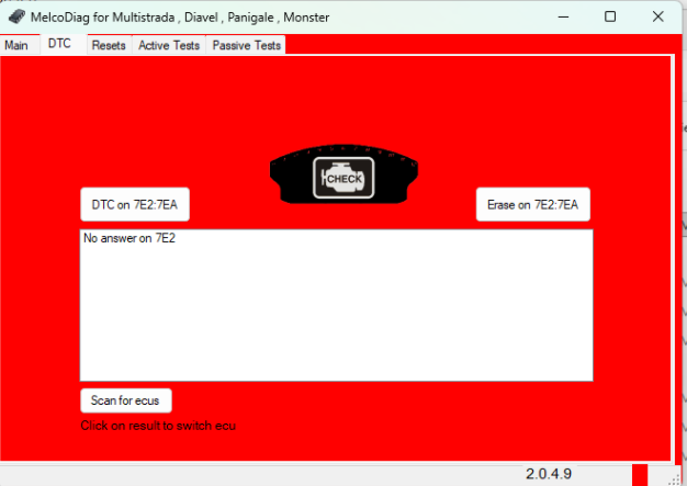

Hi there,
I tried a few times without luck, I got the license from JP, I managed to connect to my panigale succesfully (Key ON, Engine OFF) as I see the odometer information on the app, however I couldnt read the DTC codes (I tried running as admin, selecting "any bike" OR selecting "M3C ECU"). I am attaching screenshots and debug info. Running this on Windows 11 and OBD2 Adapter USB ELM327 Scanner with FT232RL 18F25K80 V1.4. The message I get is "No Answer on 7E2" when using "Any Bike" connection option. If I try with M3C I get "No answer on 500:XXX".
I am sure I am messing up some step, just cannot figure out which one.
Thank in advance for the help.

Re: Panigale 1199 2013 Connection succesful cannot read codes
yes , press scan ecu button to list all ecu in your system
then check DTC on each of them
do no tick m3c , you have a melco ecu

Great that did the trick. I scanned all ECU, and click DTC button for each one of them (I went thru them all). Then after that switched everything off, connect again and I can read and erase codes just clicking on DTC/Erase on 7E2:E2. So is it like a one time operation where you need to click on each of the ECUs? Thanks!
sometimes you shall directly goes to 7e2 without clicking the other , i don't exactly know why yet .
