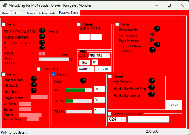

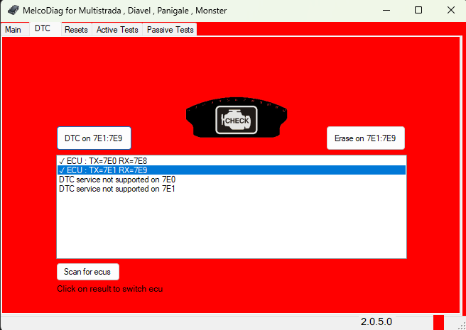

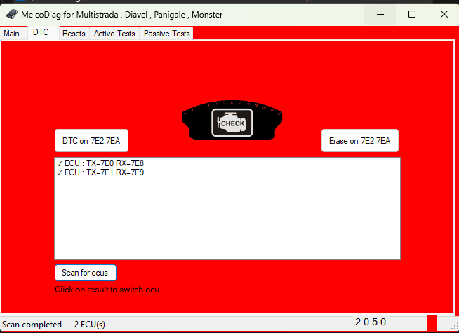

I also took screenshots.
Снимок экрана 2026-04-02 205937.png (22.36 KiB) Viewed 8109 times
Снимок экрана 2026-04-02 205852.png (21.46 KiB) Viewed 8109 times
This screenshot shows that TPS H = 0

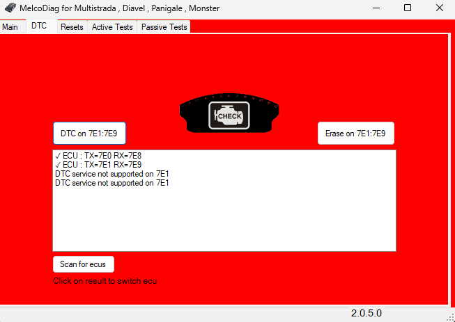

Re: Multistrada 1200s 2013
Posted: Thu Apr 02, 2026 6:23 pm
by Vestimy
I did the same as you said. I don't understand why it's not supported? :cry:
Posted: Thu Apr 02, 2026 8:44 pm
click directly on dtc on 7e2 before lanching ecu scan

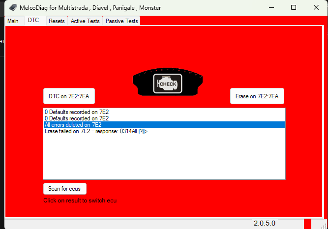

Thank you very much. Could you please check if I did it correctly? Can you tell me where the algorithms are described? Or is it different on all motorcycles? Does the TPS H indicator tell me if the value should change?
Снимок экрана 2026-04-03 190746.png (23.28 KiB) Viewed 8046 times
Posted: Fri Apr 03, 2026 5:24 pm
by Vestimy
The new version of Melсodiag works more reliably than the previous one. But I'd like to find more information about resetting the TPS, APS, and everything else. The Desmo and service oil reset works fine, and I also managed to reset the PIN.
If you need more information, I can experiment on my motorcycle, just tell me what needs to be done.
Posted: Sun Apr 05, 2026 7:53 am
thanks for the feedback , i'll put it as default download
this new version handle more wrong elm messages ,
i can see for the dtc delete the message is troncated as well
you didn't tell if you found DTC errors ?in this screen there is none but you may have already deleted it
