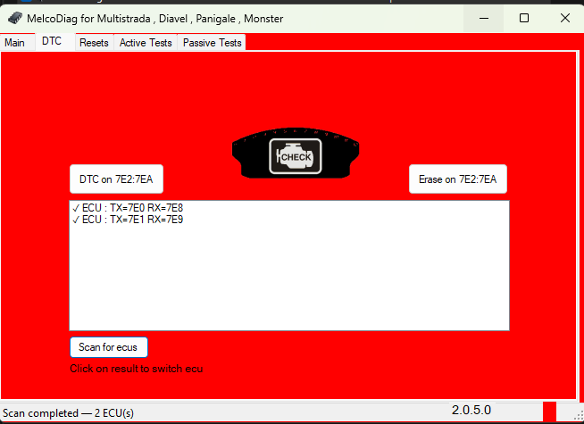

you are not seeing 3 errors , but i bet you scan for available ecu , and the elm found 3
if you get no answers on it, do not scan for ecu , but directly click on DTC on 7e2 button.
you can try with melcodiag v2.0.5.0
Снимок экрана 2026-04-02 205937.png (22.36 KiB) Viewed 8098 times

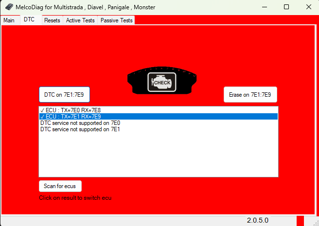

Снимок экрана 2026-04-02 205852.png (21.46 KiB) Viewed 8098 times

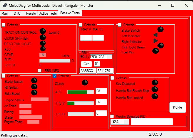

This screenshot shows that TPS H = 0
Снимок экрана 2026-04-02 210016.png (33.42 KiB) Viewed 8098 times

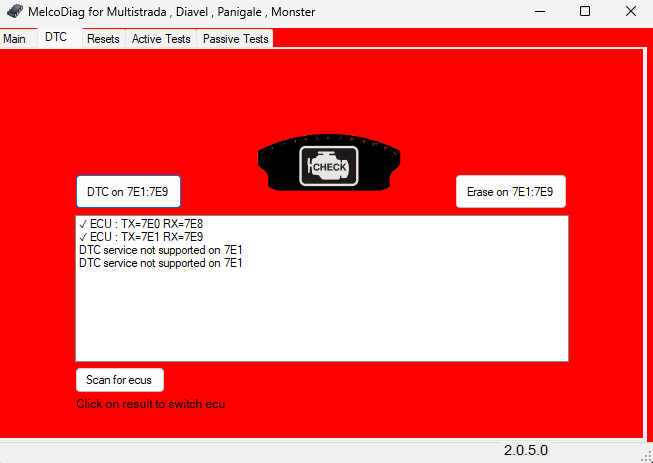

I did the same as you said. I don't understand why it's not supported? :cry:
Снимок экрана 2026-04-02 210602.png (20.97 KiB) Viewed 8095 times
Re: Multistrada 1200s 2013
click directly on dtc on 7e2 before lanching ecu scan

Thank you very much. Could you please check if I did it correctly? Can you tell me where the algorithms are described? Or is it different on all motorcycles? Does the TPS H indicator tell me if the value should change?
Снимок экрана 2026-04-03 190746.png (23.28 KiB) Viewed 8035 times

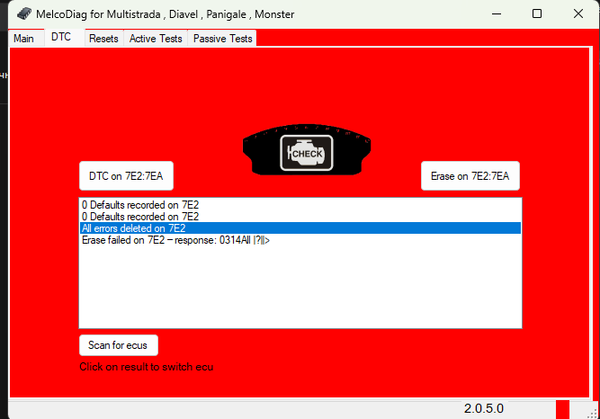

The new version of Melсodiag works more reliably than the previous one. But I'd like to find more information about resetting the TPS, APS, and everything else. The Desmo and service oil reset works fine, and I also managed to reset the PIN.
If you need more information, I can experiment on my motorcycle, just tell me what needs to be done.
thanks for the feedback , i'll put it as default download
this new version handle more wrong elm messages ,
i can see for the dtc delete the message is troncated as well
you didn't tell if you found DTC errors ?in this screen there is none but you may have already deleted it
