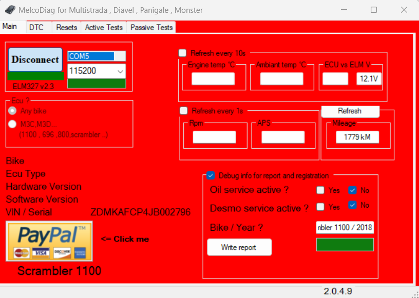

I have tried few different high quality usb and Bluetooth elm cables.
When I connect via "any bike" software connects and shows vin and model (scrambler 1100).

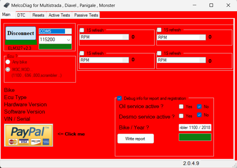

Afterwards it tells me to use M3C and connect again, after I connect it doesn't show vin, model or ecu.
It doesn't let me register either, button disappears. Only thing which works is read dtc and nothing else.
Please kindly advise.
Thank you!

Hey man! I'm having the EXACT same problem. Same bike, same year, same size. I bought a VLinker FS USB cable (USB>OBD2 adapter) and a 4-pin cable from Amazon to adapt to the Duc connector.
Same exact issue as you, though.
When I'm connected on M3C, it outputs the following info in the MelcoDiag folder on my PC:
"File generated On 5/18/2026 3:43:22 PM"
"ELM version : ELM327 v2.3"
"User Bike = scrambler 1100 / 2018"
" vin:NO DATA>
21 PIDS active founds
174_1C800000C0930E07
024_0000000020000553
080_1E61E603452005DF
178_0880000016870EF3
17C_00000000BE960E85
188_7FF37C27806F4728
022_000000000003F7F2
023_000000547F830775
240_0000012C000F4B87
020_00405010000089DD
018_0002A00040C049C1
019_9609600000000A01
100_C8121100000005D2
300_3DA0000006F38C3B
230_0080100000000CD8
220_0000000000000C96
120_02007A190C002C96
200_0000000000000C96
180_D90044003E3E10AB
150_0003107A00024D64
"EE3B887C"
"Bike = 4"
And I know what my VIN is (either from looking at the bike, or from connecting with "any bike" selected.
