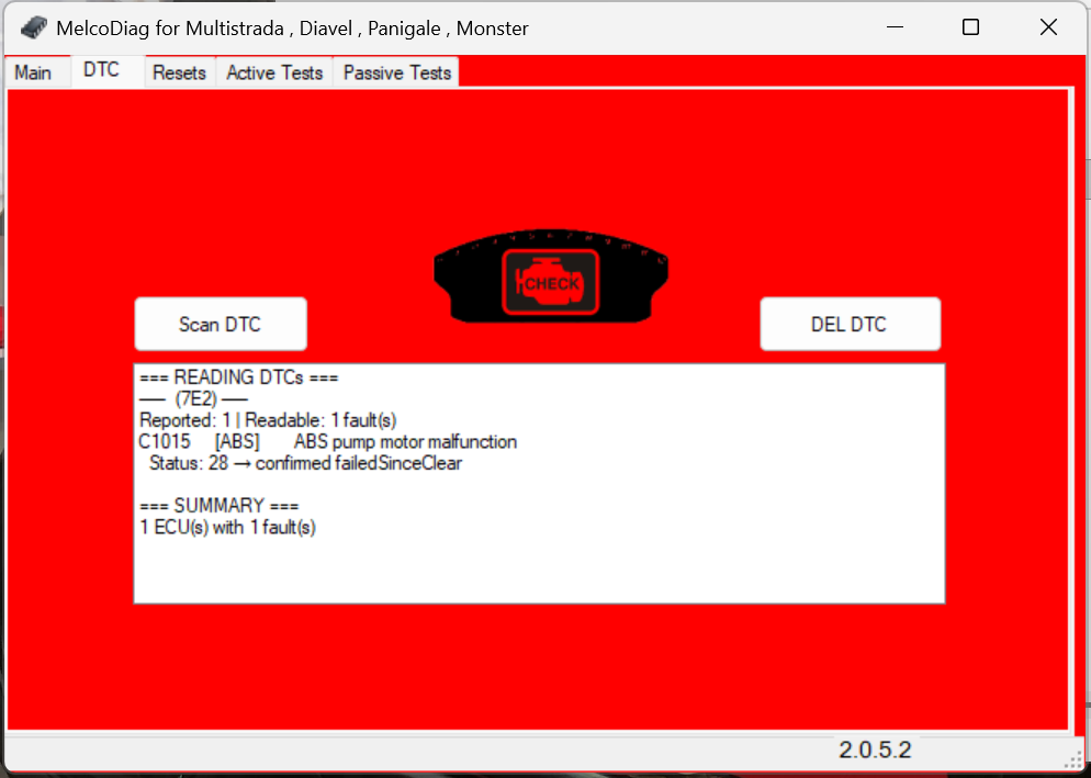

so i have connected ok with bike. i can read things like TPS, MAP sensor, engine temp all these things.
But i am unable to reset TPS, it opens a new Melco Diag front page which is not connected, so i have 2 melco diag running, the new one has the warning about resetting/loosing UPMAP. I have to shut the Melcodiag s/w down in the taskbar. S/W version is 2.0.4.9
My PC is windows 11.

sounds strange , cn you try with the version 2.0.5.2 ? then i we have same version to compare

Hi JPL
so i have loaded version 2.0.5.2, this now allows me to reset the TPS and APS. I also found that the ECU's can be read properly now.
Some other buttons like the Clutch switch, Fan test are not working.
Screenshot 2026-08-13 144654.png (88.24 KiB) Viewed 37 times

thanks for the feed back
for the live switch status you can help to debug in the passive tan
for the fan test i'm surprise it don't works , i will check later
