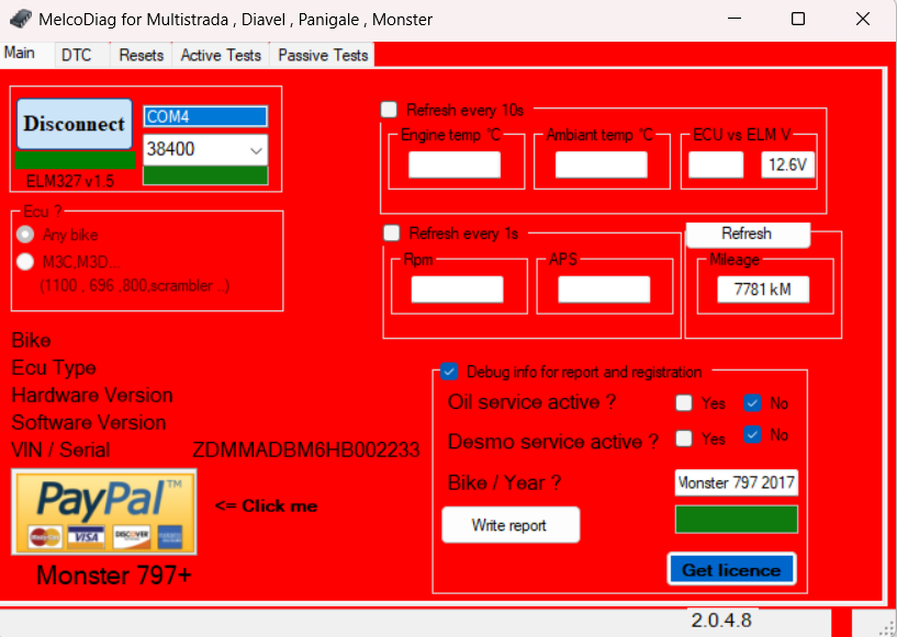

Greetings,
I purchased all the necessary cables and installed the softwareb(Elm327 v1 5). I had an annual reset code on my dash (2017 Monster 797). I connected the bike and was able to reset the code without a license. The issue is, when I connect using any bike, it shows Monster 797 but won't allow me to get a license because all the ecu and hardware data doesn't show. When I switch to M3C, it detects my bike but incorrectly lists it as Scrambler with incorrect VIN. I have included a screenshot of my connection. When I try to register I receive an error message stating there is information missing. Please help with proper bike identification and license.

- Screenshot 2025-10-11 180116.png (98.94 KiB) Viewed 2003 times

can you send me the full registration link ?
it's copied into your clipboard when you press blue button , just past it here
ok noted your bike is identified as a scrambler it seems they share same electronic becuase the reset was successfull

Here is the registration link from the clipboard.
300_0A8100001E65C012
Global_ vin DATA vin DATA vin 135A905A444D4D4144424D364842303032323333AA vin 7F1A12AAAAAAAA vin 7F1A12AAAAAAAA vin 7F1A12AAAAAAAA6 PIDS active founds 081_00000000C8000000 020_0000400000000000 022_0000000000000230 100_01000A0000040000 201_0000000044141E65 211_397D0238D24204A1
ZDMMADBM6HB002233 OIL0_DES0
Here is the report just before I clicked on the blue tab for license.

Re: Ducati Monster 797-Help Please!
you can try to replace the 1st empty line in the registration form with 'no data

I tried to add 'no data' to the clipboard and received this message:
serial empty
Error: Missing some information, licence cannot be generated
Be sure your software setup/elm is working
You can post your debug report on the forum for checking : https://jpl250rs.ddns.net/forum
Here is what was posted in the clipboard link:
'no data'

I have also included a screenshot of what is displayed before I click get license.

My Monster 797 appeared to be registered then the blue get license came back. However, When I connect via M3C, It comes up as Scrambler and shows that the bike is licensed and registered. I will continue to see what is going on. I do appreciate your guidance on receiving the license via email.
