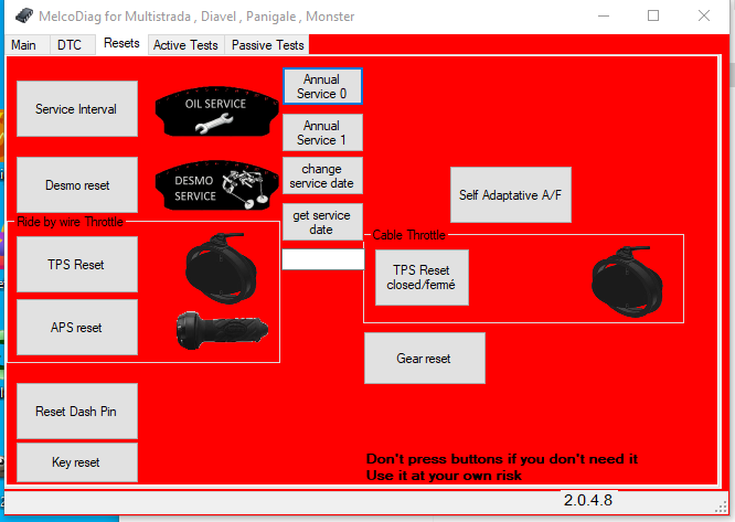

Hi, I repeated the procedure from the beginning:
Current mileage of the motorcycle: 15,039 km
In the reset tab I pressed the grey button "Annual service 0"
"get service date" does not give output.
new Oil/Annual service :mrgreen:
WhatsApp Image 2026-01-03 at 17.01.19.jpeg (137.42 KiB) Viewed 7593 times
and the log after today's new reset

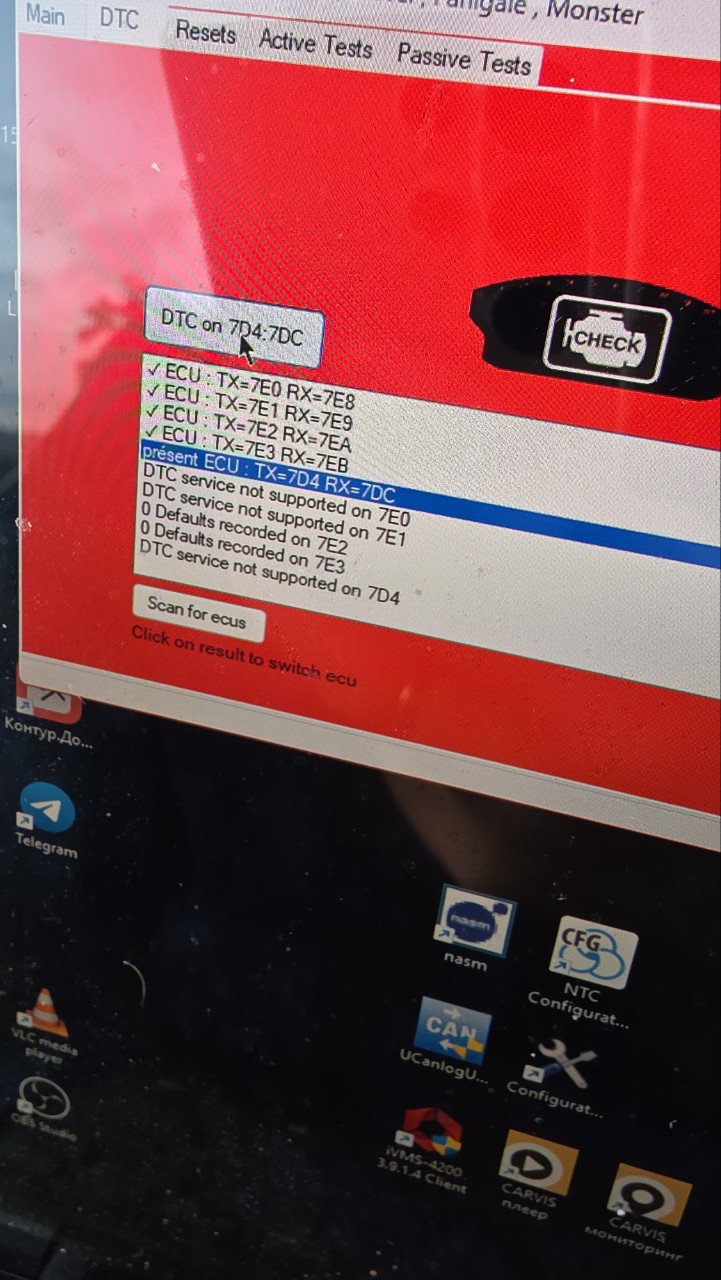

I have some problem with reads DTC service not supported on 7E0, this is my report:
"File generated On 07.07.2026 19:15:49"
"Software version 2.0.5.1"
"Auto Detect Bike = Supersport 950S 2021"
"User Bike = Ducati SS 950S 2021"
"Hardw = DU CAX20"
"Softw = DN2LT000653"
15 PIDS active founds
018_0002A000610041B5
019_96096000000001CE
120_22046F1850001D75
200_0000000000000D8B
124_0100000000000DD6
024_0000000000000FB1
174_F07F00487B860A64
178_F47F0000F07F0AB1
17C_FA7F0100CB9D0ABC
020_0040731000004731
022_000000000003FC3D
080_1F72BCC045000F32
023_0000005480130CC9
100_C81201AFFF001E27
188_7FFF7C73800
"Vin = **001206"
"FADC2900"
"Bike = 8"
? outp='**001206'
PaniVIN: **001206
? outp='DU CAX20'
? outp='DN2LT000653'
Tell me please, what should i fix?

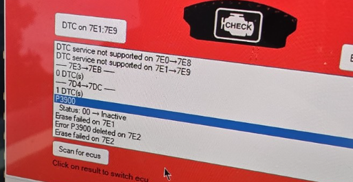

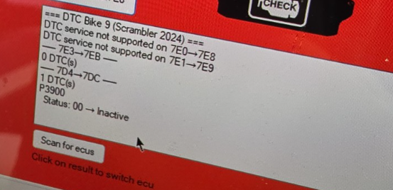

Results of tests:
"File generated On 07.07.2026 22:23:57"
"Software version 2.0.5.2"
"User Bike = DSS950S2021"
"Hardw = DU CAX20"
024_00000000000008E2
188_7FFF7C777FFB4A49
022_000000000003FA73
18C_7FF7800300000B0B
023_00000054800B0A69
018_0002A000610040A8
019_96096000000000D3
174_F47F00466E860F00
178_F67F0530DA7F0FED
17C_F67F0100D49D0FF0
080_1F62BCC045000875
100_C812019FFF0017BD
020_0040730000004609
*ECU found TX:7E0 RX:7E8
*ECU found TX:7E1 RX:7E9
*ECU found TX:7E2 RX:7EA
*ECU found TX:7E3 RX:7EB
*ECU found TX:7D4 RX:7DC
"Vin = **1V00**001206"
"DTC = 025800 0359023900000000 025800 0359023900000000 025800 0359023900000000"
"FADC2900"
"Bike = 9"
? outp='**1V00**001206'
PaniVIN: **1V00**001206
? outp='DU CAX20'
Teo
Posts: 15
Joined: Tue Jul 07, 2026 4:27 pm
Re: Partial data read - only VIN
Post by Teo »
Hi, can you help me read all ecus and erase faults from bike?
