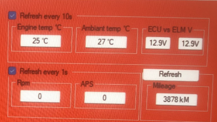

After connecting Melco diag i recorded the below M sensor readings, either the V or H remained at 0, is this an indication of a faulty sensor?
Engine was not started, just turned bike on.

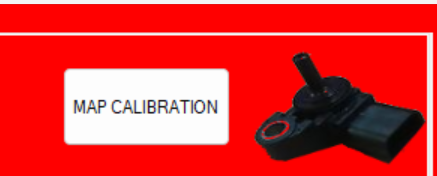

After replacing the M sensor would i need use the calibration function? and how would this work? is it safe, would i delete any thing?

you should check sensor engine running.
if it stay on 0 our 254-255 the the sensor is dead.
if you need to replace MAP sensor, yes a reset could be usefull even if i never saw a big difference doing it
