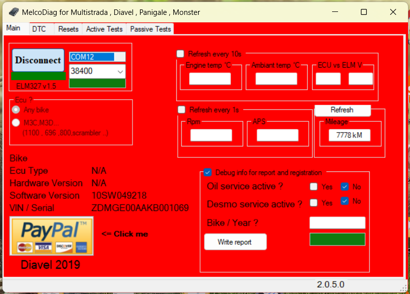

I own a 2019 Ducati Diavel 1260S.
Software: 10SW0449218
VIN: ZDMGE00AAKB001069
I’ve just had the Desmo service and the annual service done, and I’d like to clear
the service notifications using your software, but I’ve run into a problem.
Here’s the situation:
1. I connected the motorcycle. - OK
2. I read the data (it only picked up the model, VIN, and software version)—unfortunately, it didn't retrieve the ECU and hardware data. :(
3. I registered the license. - OK
4. I copied it into the application folder. - OK
5. I launched the app, and everything works fine—except for resetting the service and Desmo indicators.
Do you happen to know what the problem might be?
In attachment photo.

Re: Diavel 1260s - 2019 - Service info
still the 10sw software
i have not found yet why this one in particular is so difficult to reset on some bikes , and working on different ones

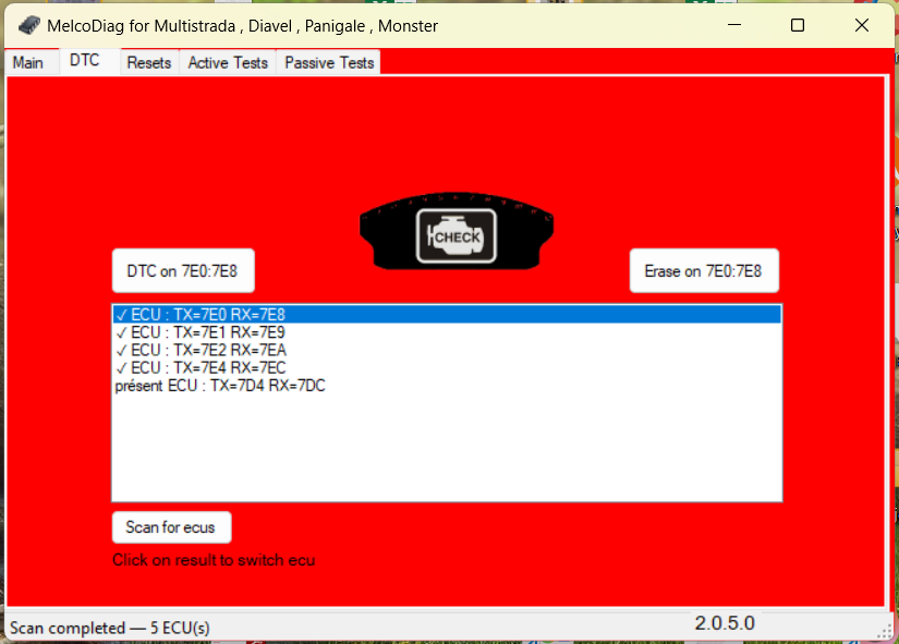

So unfortunately, no one has been able to resolve this issue? :(
I've attached the log file below.
Do you have any alternatives?

*ECU found TX:7E0 RX:7E8
*ECU found TX:7E1 RX:7E9
*ECU found TX:7E2 RX:7EA
*ECU found TX:7E4 RX:7EC
*ECU found TX:7D4 RX:7DC
