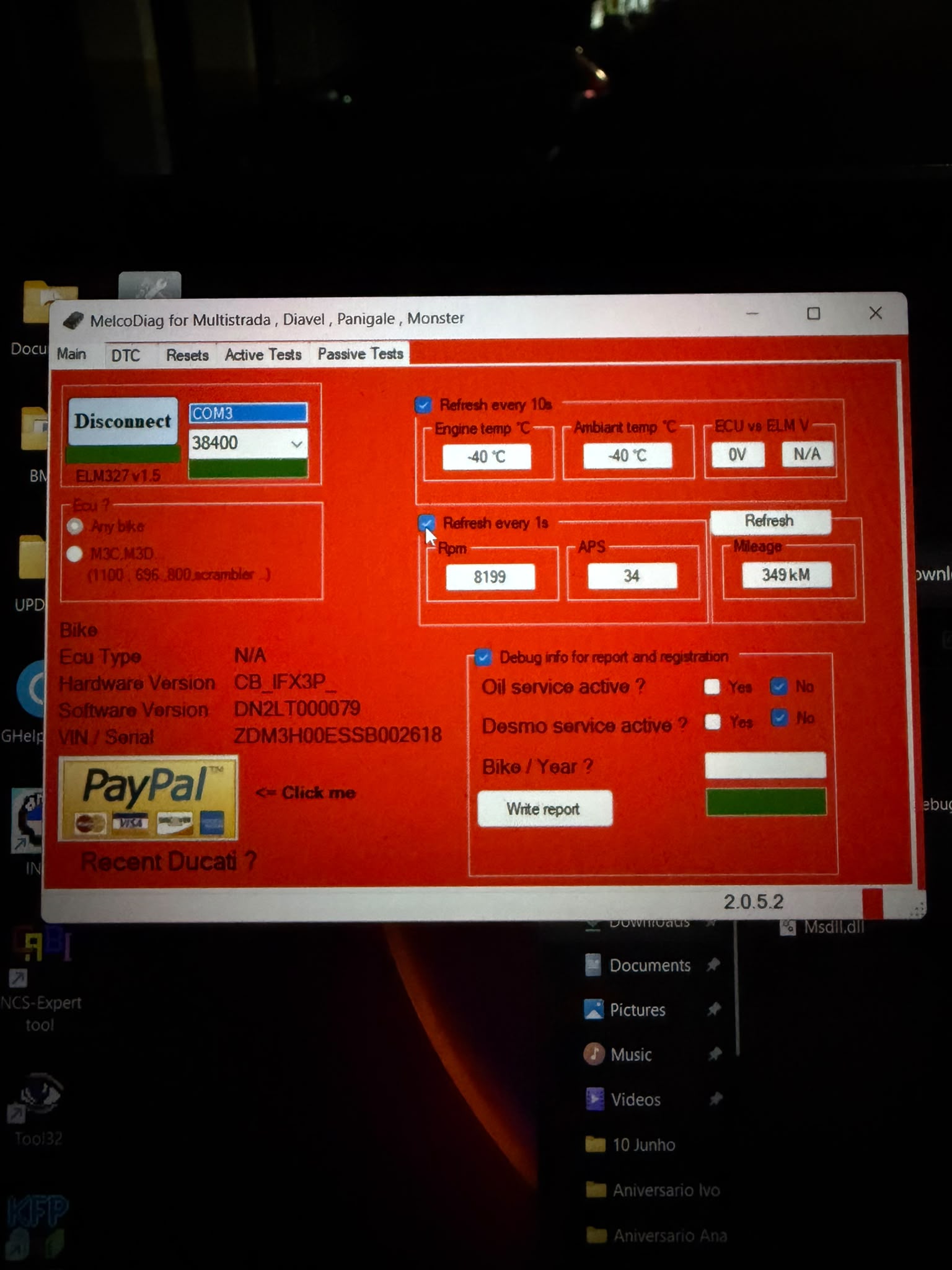

I'm having the same issue on my 2025 Panigale V2, I can connect to the bike and I've ran the Service Interval, Annual service 0 and Annual service 1 but with no success to reset the Service warning or the banner.
It seems to not be reading some info properly as well, ECU appears as N/A and some values are not correct (Milage is much lower than real and RPM shows 8000 when the engine is not even turned on)
Should it be like this or did I do something wrong?

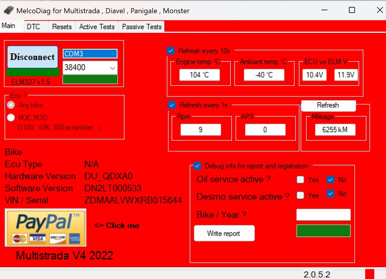

I have a similar issue with Multistrada 2024 V4.
Melco app seems to recognize my bike showing the correct VIN. Some specs are way off, like temps and mileage. When I click on Service Interval button or Annual Service 0 or 1 or change service date, the OBD II illuminates serious of lights, then I hear the beep on my laptop, but it does nothing. My bike still shows oil service required. For reference, my laptop has Windows 11.
Should I open a new thread or it's ok to continue here?
