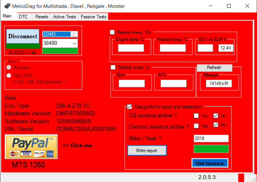

After identifying my motorcycle, I was able to retrieve a license key sent by email. I copied it into the folder with MelcoDiag, but I still have the blue icon "Get license" and it is impossible to use the functions of MelcoDiag.
Thank you in advance.
"File generated On 18/08/2026 14:34:46"
"Software version 2.0.5.3"
"ELM version : ELM327 v1.4b"
"Auto Detect Bike = MTS 1260"
"User Bike = 2018"
"Ecu = 286.4.279.1C"
"Hardw = DNPBT000602"
"Softw = 10SW046858"
20 PIDS active founds
018_0002A000410044EC
019_96096000000005BA
020_000053000000483E
300_4294000A37454CC2
230_091E1C000030FC1C
120_68647B1B90001BB4
200_0000000000000BC5
174_03800000986A03E3
022_000000000003FE07
023_000000FC7FA70E3B
110_00004310000C6B22
178_FD7F0724857F0305
17C_00000000E395032D
188_800F7FE7806B4ED9
024_000000000020072C
080_1C42BCC0302007B5
100_C70604604400072C
240_0200500442000F02
220_0000000000000D8B
130_0000050003E60900
"Vin = ZDMAC00AAJB001980"
"9A0B0994"
? outp='ZDMAC00AAJB001980'
PaniVIN: ZDMAC00AAJB001980
? outp='286.4.279.1C'
? outp='DNPBT000602'

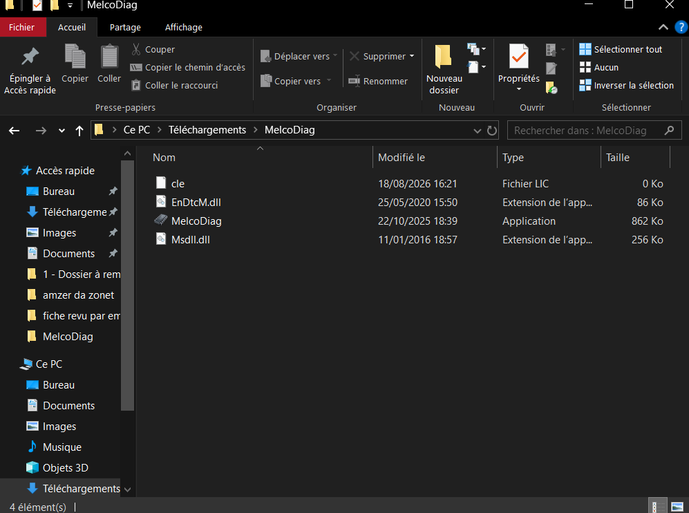

No, i didn't touch anything, i downloaded it and slipped it into the MelcoDiag folder.
Capture d’écran 2026-08-18 163618.png (73.1 KiB) Viewed 67 times
Re: Multistrada 1260S 2018 - No licence
cle.lic should be 1k not 0k

I received the new key by email; I'll try it when I get home from work, thanks.

The problem is resolved, it did come from the first key that was not recognized by Melcodiag, I was able to reset the annual service, thank you for your help!
