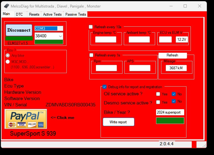

Got a message that mail has been sent after adding "no ecu data". The software only picks up my VIN and that is it. I am using ELM327 V1.5 with FTDI chip
2024 SuperSport 950s
Re: 2024 SuperSport 950s
After receiving the LIC the software behaves the same. All I see is the VIN and the miles are read wrong. Report beneath. I am using Version 1.5 of ELM327 with FTDI chip

- This is what I see
- JP.jpg (87.5 KiB) Viewed 6009 times

i'm not so confident with the version1.5 but i see an issue with your bike
software has identified it wrongly
have you change the bbs or ecu ?

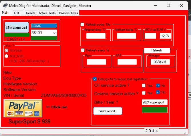

I bought the V1.4 advertised on amazon for this program. This is the log. I will add the setting on the program. Let me know if i am doing anything wrong. My ECU is continental M4C, and I get the wrong miles count on the software. Im at 9000 miles. I bought the bike at the auction. Not sure if anything was changed on it.

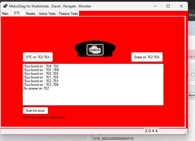

- 1.jpg (88.61 KiB) Viewed 5984 times
- 2.jpg (58.99 KiB) Viewed 5984 times

i see DTC is not right
"DTC = FC7F01007F680F6B FC7F01007F680F6B00800100796803E9 FC7F01007F680F6B00800100796803E9C806000FFF001A57"
it didn't switch ecu but give the content of the buffer
that's explain why you have no answer on 7e2.
if you wanna see the dtc on 7e2 , don't do a scan , but directy press DTC button , it's by default on 7e2
for the mileage , it's probably my fault , it's not debugged on your bike yet

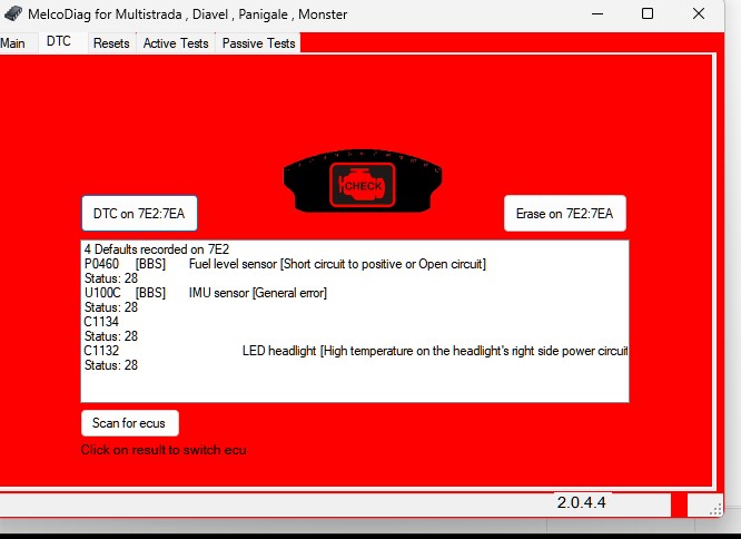

I got the error codes. I cleared them and will see if they come on again. I never had the check engine light on for these errors. I removed the gas tank and all the gas to fix the tank so maybe this triggered that code for the sensor. I had the cluster disconnected so maybe that caused the IMU code.
- Error codes
- ERROR.jpg (58.53 KiB) Viewed 5936 times
some ghost errors can come when the battery drop below 12V
nothing to worry if that don't comes back after you did a small run
