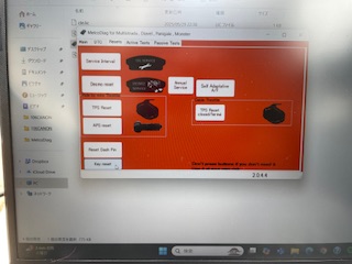

Thank you for your reply.
I followed your instructions to launch MelcoDiag with an account with permissions and unlocked each file and software in the file properties in Windows.
However, the only option to reset is (Key reset.)
Is there anything else I should try?

Re: I haven't received the license registration email.
haven"t you ask a licence for different bikes ?
you shall not mix the files
